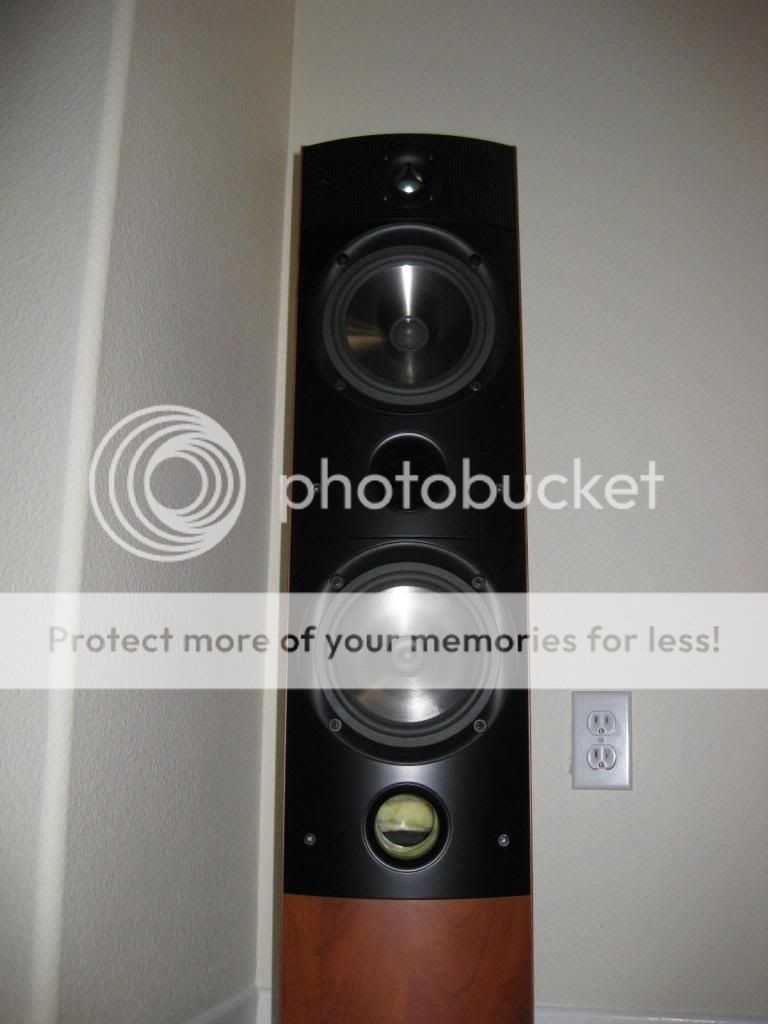

Hey guys, I just picked up an unused but very beat up pair of PSB Image T55s today. I was hunting for a single* T55 for my future center speaker, and I worked out a deal with my dealer. He was planning on fixing whatever was needed to sell these at discount, but just hasn't got around to it yet. Instead I bought these at dealer pricing, I do the work, and he will accommodate me by obtaining whatever part I need for free under warranty from PSB. This works for me because I can't see any blemishes anyway (if rather minor) behind a false screen wall, the final price is just about half of a pair anyways, and these don't sell individually AFAIK. I can look at it as a free speaker with some work, I'm hoping.
This pair got beat up somehow while still on the pallet. One works perfectly, but has two busted feet (don't care, they come with optional feet too in any case), and a couple/few dings blemishes. The broken feet pieces were everywhere inside the open box, and just about all the styrofoam was decimated. No visible holes on the exterior of box.
The other was already out of the box (because it was decimated), and the dealer said that when he plugged this* speaker in, there was no sound at all (but I found the tweeter still works today, read below). The very bottom front panel is completely off (unglued).
I hooked them both up (that's how I know the first one works fine), and the second one actually has a working tweeter. When at the store I immediately thought it must be the xover when listening to his story, and that's what the dealer is guessing too. So I took some pics, but can't include them all because some are so blurry. I tried no flash, but they didn't come out. I couldn't find anything that was disconnected, so I was hoping maybe someone can guide this speaker noob. Thanks. If anyone needs to see a particular part/angle/anything, I will be happy to oblige.

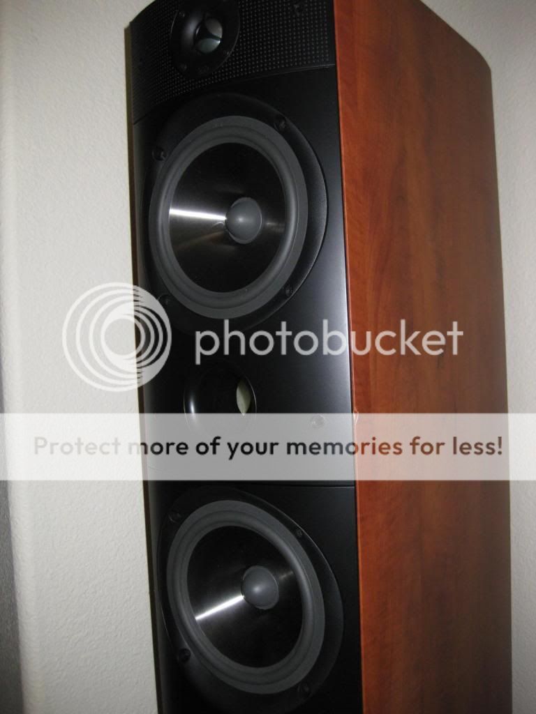

This is how the speaker looks front at bottom (panel is disconnected). What glue shall I use to reinstall it when the repair is complete?
I unscrewed both drivers just to look. The first is the upper mid driver, and the second is the beefier driver.

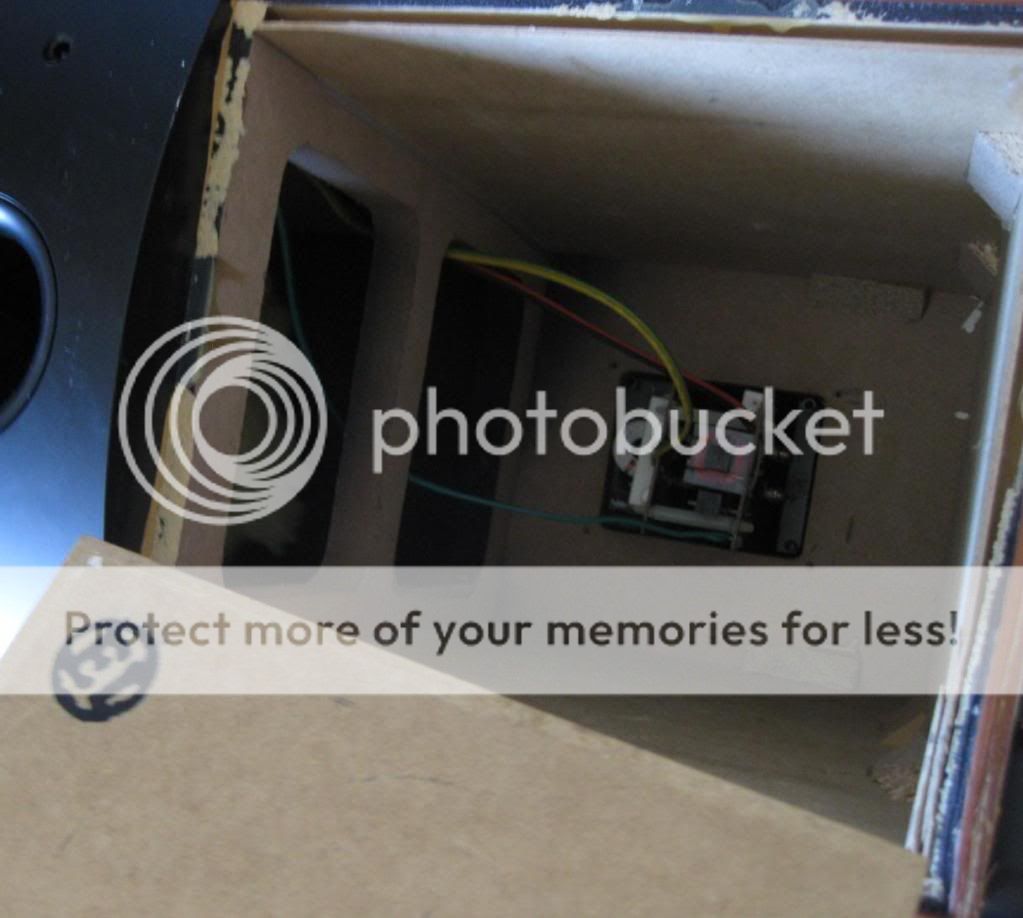

This is looking skywards from the bottom.

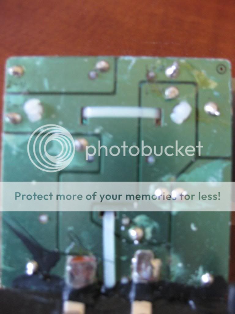

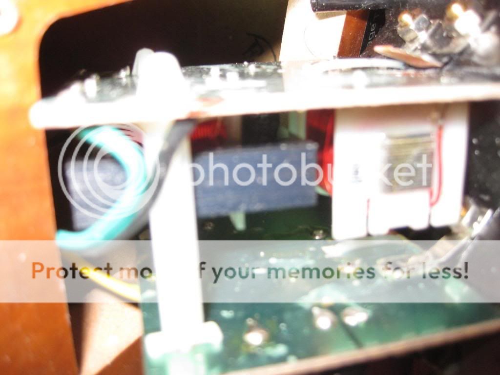

I unscrewed the terminal cup to look at the xover. I can't find anything peculiar yet, but I have no idea what to look for either.
Reverse angle

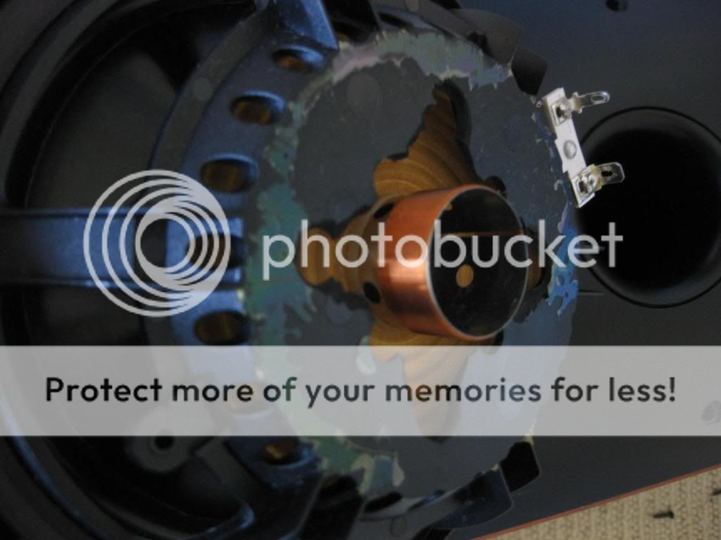

Well, for starters, the upper woofer doesn't have a magnet, so that will cause it to not put out any sound.
That speaker was clearly dropped and I would talk to the dealer about whether it came in that way, or if it happened at the store. Either way, it needs a replacement driver. I would also look at the bottom of the crossover and check for cracks on the copper traces. If it was dropped hard enough to dislodge the magnet, it could easily damage the crossover. Remove it from that cabinet and try it on the other speaker to check for bass/treble operation.
Nor it does! I don't know how I missed that. Even if dropped it is pretty poor for the magnet to fall off. In a decent driver it should take a huge explosion for the magnet to come off. I have never seen that before.
After looking at those pictures, all I have to say is DIY, DIY and DIY!

Yes, I missed it too and I feel sorry for jostenmeat - the dealer
clearly wanted to move these speakers out.

Don't feel too sorry, their arrangement means JM gets a new driver to replace it.
If that is all that is wrong, he has an easy fix. I think the other option is that a Xover may also need to be replaced. Either way, not much difficulty to get them back in the game!

Thanks guys!! The damaged speaker was not simply dropped. There is no* box to even speak of. (Total decimation is my guess.) Who knows what happened to it?! Even the dealer has no idea, except that it was still on the pallet which seemed to confuse him. I have already followed up with him, and he says drivers, xover, feet, anything I need, no problem, free, and shipping is roughly a week he says. I am waiting to send the email with final list, replete with serial number of my speaker.

So I picked up some alligator clips and 9V leads today, and the bass driver is working. My first 9V test was pretty fun! lol. I asked about their multimeters while I was there, $16, but I decided I'll just get one for the day I might need one, heh.
Good catch on the missing magnet highfigh! I failed to look under the driver, fearing stressing the terminals by pulling, and I thought gee this is light and must have some pinner magnet for upper mids or something. hahaha
The upper baffle is cracked, and the dealer says to use some silicone to make sure it's sealed. He advised against replacing it, even though I assume I could get this for free as well from PSB.
I have some apprehensions with testing the xover, where I'm hoping that you guys can assuage my fears. I used to have what I think was a decent soldering gun maybe 20 years ago, but now I have a cheapie iron that I've used only once, and I fear it doesn't get hot enough to quickly melt solder. Therefore, I'm afraid of hurting the xover if I have to apply the iron for significant stretches of time? I'll be ok if I go for it? I can't find any obvoius* break in the copper traces, if I'm not mistaken.

Missing magnet!! :eek:
Xover bottom
Xover side
This is what I will glue
The cracked baffle

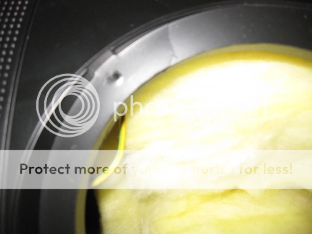

This is the "good" speaker. I looked it over once, and I only find one blemish (bit of a doozie) on it; it's on the right edge of the baffle, directly right of the upper port:
This might make it more evident?

I don't understend where the magnet went. Was it in the bottom of the box or is it just gone?
J
jostenmeat
Gone. No box. No instructions. No extra/optional feet or spikes. No styrofoam. And um no magnet. This speaker was just sitting in a very cramped storage room with the bottom disconnected panel sitting on top of it. I could see in the dealer's eyes that he was second guessing himself in giving me both, but I think I convinced him (I wanted to try, and even just getting the single speaker may have not saved me anything at all in pricing, but that's just a guess). I figure worst case scenario, I have a back up tweeter and bass driver. The drivers cost $75 and that's at dealer's cost.
I would have done the same thing. Why not take a free speaker?

Hmm, I guess until someone does assuage my apprehensions with detaching xovers, I'm thinking of just asking for a new xover. Of course that means I have to detach it anyways, but this means I would never have to detach the xover in the properly working speaker.
If I didn't really need one, I'd feel slightly guilty about taking one from PSB, but if the bass driver is good . . . doesn't that necessarily point to the xover anyways? Thanks.
zieglj01
zieglj01
I would replace the crossover on the bad speaker - It stays on the
terminal plate. The new crossover will come attached to the new
terminal plate. That crossover looks to have been hit - for the most
part, it will save from future problems.
Good eyes there;):D I think it is missing more than just the magnet as it seems the voice coil is all that is left. It is nice and shiny though:D
