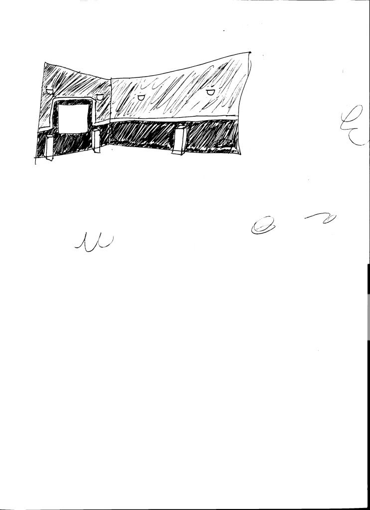

Ill explain my exact idea now that i see the room.... mayve ill be easier if i scan some drawings and post them.. Ill do that right now.
That is the basics of what i want. As you can see the closet door will be removed. For the towers i will make holes on the new wall were they will fit. The wall is about 4 inches so my speakers will still stick out about 3-4 inches. This goes for the center speaker too...

I dont plan on painting. I am looking into doing a 2 color theme.. First will be from floor to about 3 feet up the wall. It will be likely a dark wine color suede fabric.. the second will be black... not sure if ill use suede for this or other cloth.. might even use the sponge that goes under carpets on the wall under the fabrics to make them soft...
Comments? ideas? questions?

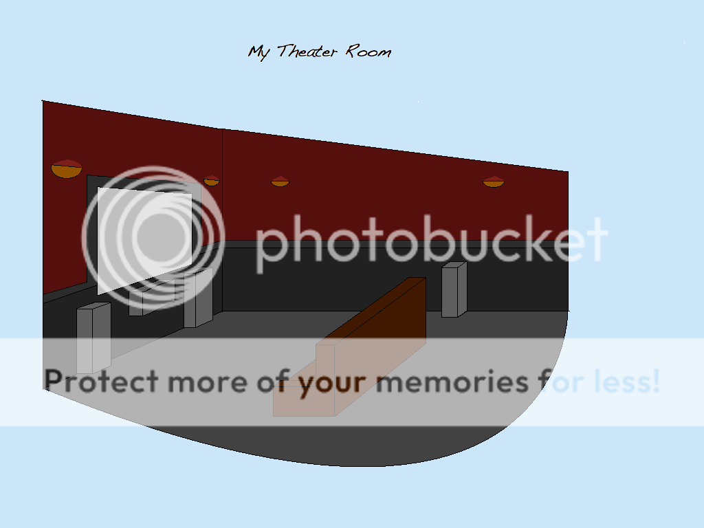

Just finished some quick sketches of what i imagine the room to like like... Forgot to add a AV tower in the rear and the projector.
Comments?
