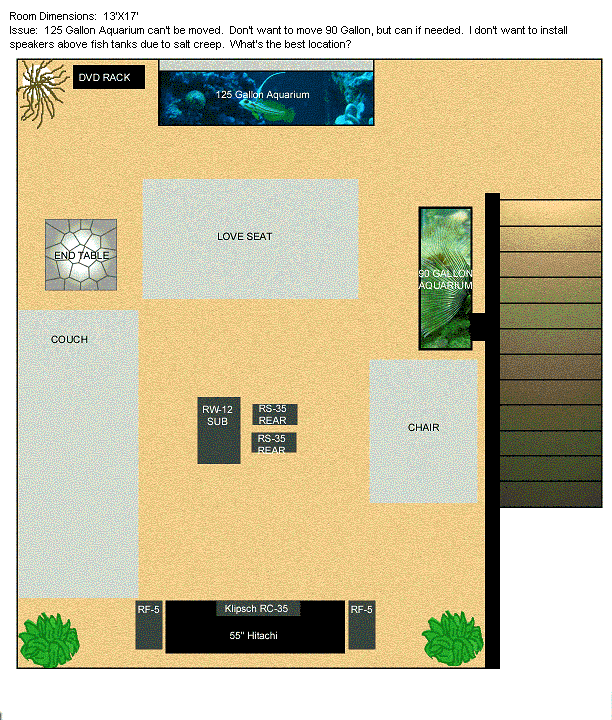

Well, I did a layout of my room where my TV/Speakers are to go into (see below).
My intention was to have the sub next to the TV, but that would push one of the mains in a corner behind a couch. Anyone see a better option to start with when setting up my system.
Then there's the silly dipole speakers. I read the following: "Bipolar/Dipole surrounds usually perform best when placed on the side walls directly across or slightly behind the seated listening position and at approximately 18-28” above the seated ear level position." and "Direct Radiating surrounds usually perform best when placed behind and slightly higher than the listening position, spread apart the same distance as the mains and slightly toed in." (http://www.audioholics.com/techtips/setup/loudspeakers/loudspeakerplacement01.php).
Based on this info, it seems the direct radiating speakers would work better for a 5.1 setup in my room. I could move the 90 gal fish tank, but it is hard plumbed in the wall and would be a 1-2 day event to move it 3 ft. eastward. :( I'd like to avoid if possible.
Any suggestions much appreciated.
What about the putting the sub in the above referenced corner behind the couch or between the chair and TV?
Edit: Bear in mind that if you are going to get the best from your sub (and all your speakers for that matter) you will need to experiment with location and my experience is that the difference between a so-so location and a very good location is not subtle, but dramatic. For me that ment outboard of my right front speaker which is not a corner location. In the corner, which is very common location for a sub, my sub sounded boomy. Go figure.
Nick
thats probobly one of the weirdest layouts ive seen. and ive seen.. not that many
Why you say that? Cause the speakers are in the center of the room? I was confused about them, so there they sat.

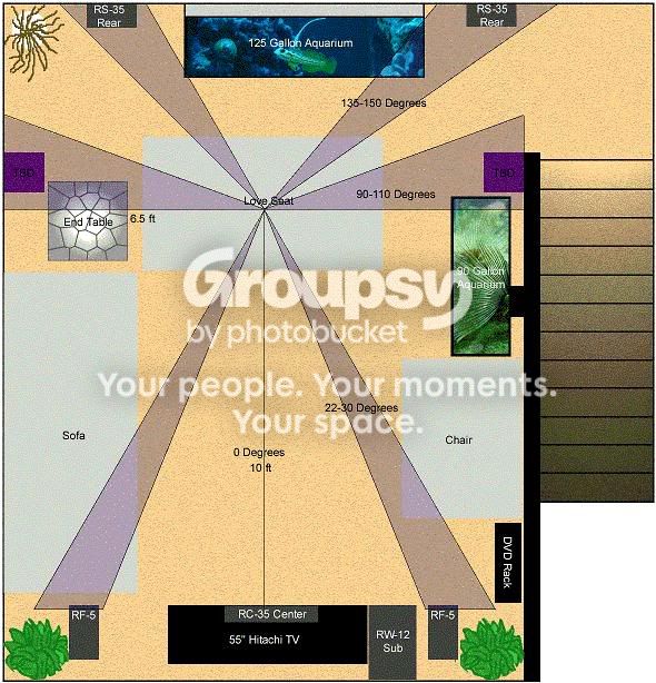

Here is this better:
I'm going to go with that setup for now and move it as needed. The rears sit just above the height of the aquarium. I think I may end up moving the towers next to the TV and the sub more to the corner.

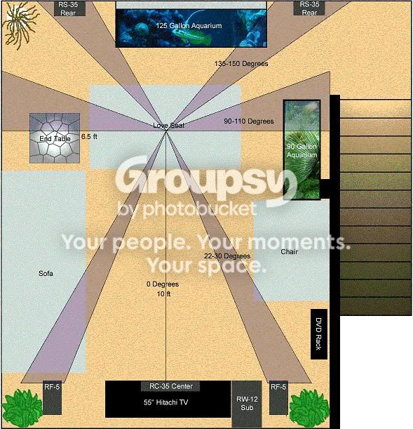

Then within the next few months, when I can move my fish tank, I'm thinking I'll get two more speakers to create 7.1:
Based on what I read yesterday and today, this should work out, correct? I also need to get an AV component rack as there isn't much room under the stand for the future components I want to add. Finally, I want to make the DIY absorbers mentioned earlier. I found a place that can put images onto large pieces of cotten near my house after talking to the fabric store. We're thinking the Virii Twins, Gollum, Jesica Albi/Sin City, Species, and one of the Aliens. Not quite sure.
