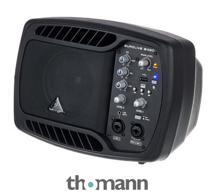

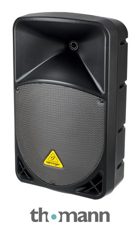

You don't need a headphone amp - all you need is a new PA speaker with BT support, like this one:
Then you said "a lobby small fitness center" - how many squre meters?
If it's as small as you describe and low budget is a must then this may work:
but I'd recommend upgrading to more a powerful speaker:
If BT 4.2 audio quality is not good enough, you could go with a cheap 3.5mm to RCA cable

Thanks a lot, but I can't change my PA speakers, they are definitely installed... :/
