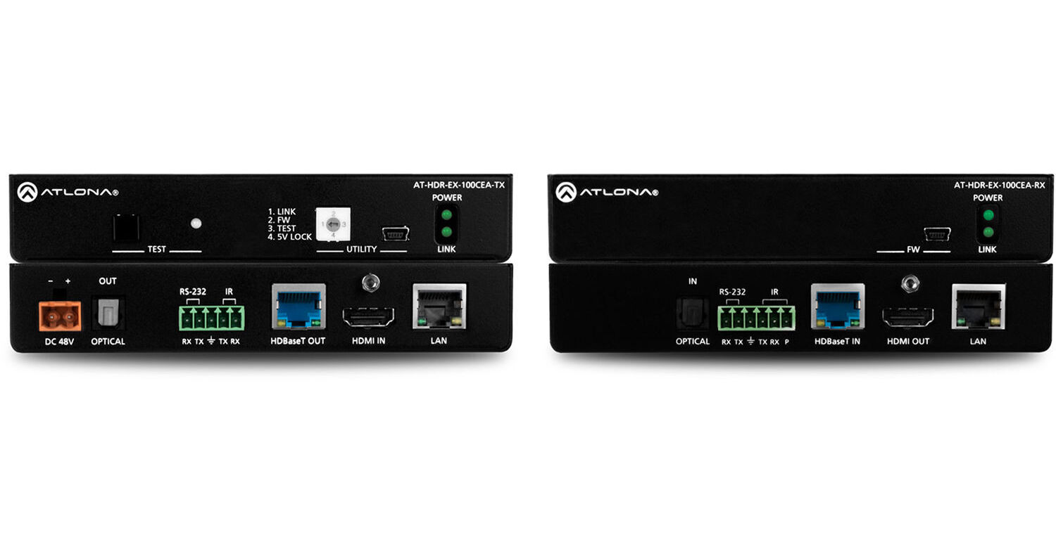

HDBaseT (HDBT) is not a Ethernet solution. It's a point to point connection using the category cabling that you have. So, if you have a spare network cable that runs from the location where your receiver is, to the TV location, you can pull that cable off the network, and use instead for point to point extension of HDMI. The statement that you must replace the HDMI cable is VERY incorrect.
That said, HDBT does introduce lag into the system which is certainly noticeable if you play games. So, be aware of that.
HDBT also does not support audio return channel (ARC), so you will need to have all of your equipment plugged into the AV receiver.
Be aware that HDBT is point to point. So, you must have a single cable between the two. It does not use your home network.

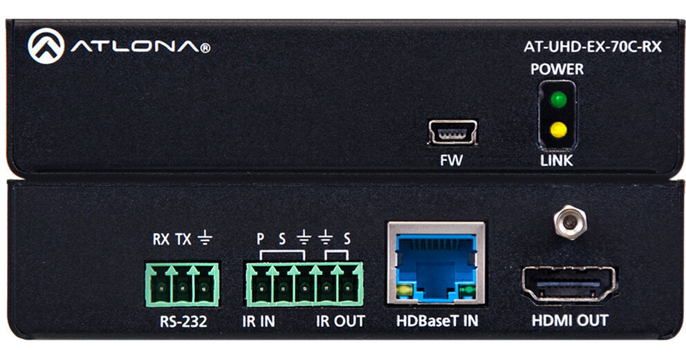

Be aware that the HDBT unit linked above from Atlona is just a RECEIVER. You need both a transmitter and a receiver for HDBT to work. So, about $500 or more for a quality set.

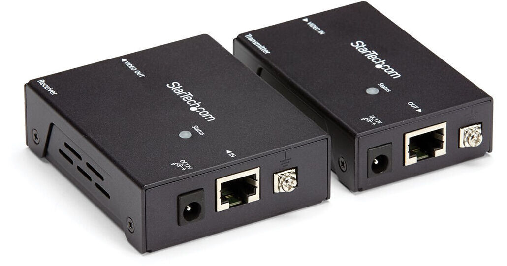

You must felt terrible to see a damaged HDMI cable then. I agree with above the installation with the conduit. And if anybody is seeing this and want to renew their wiring, pick a higher category (I would prefer at least cat6a) for future proof.
HDMI over ethernet is taken as HDMI transmission over an ethernet cable sometimes. HDBT extender runs over Ethernet as well. And BTW, HDBT does support ARC (plus eARC for a higher standard) like this kit I am using:
