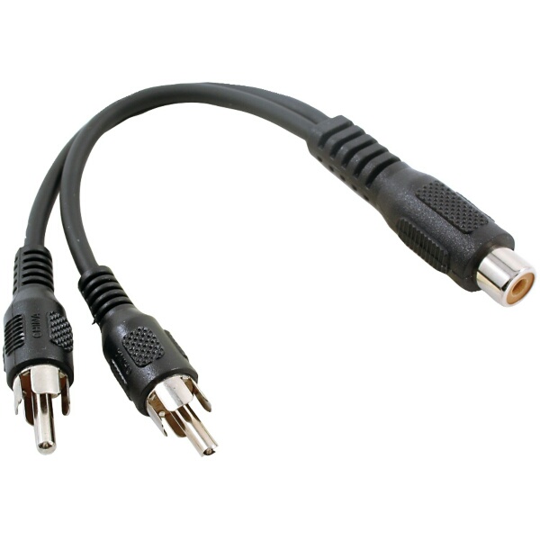

Maybe try the other inputs. You should have some form of volume control to blend it in with your speakers. From what I read that THX input might be made to work specifically with receivers that have THX controls or something. I'm not sure, but not having a way to adjust the volume or gain isn't a good thing. Do you have a Y adapter?
PS, one of these.
PS, one of these.
