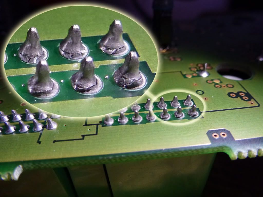

I have a spare laying around, figured I'd give it a shot. It kicked on almost immediately (how to' says a minute or so) I'm going with stuck fan or dust bunny...and some witchcraft of course. I'll be curious to see how long it lasts. I know the solder joints can def go bad and that was one of my first guesses, but the blow dryer wasn't on long enough to make anything remotely warm.
