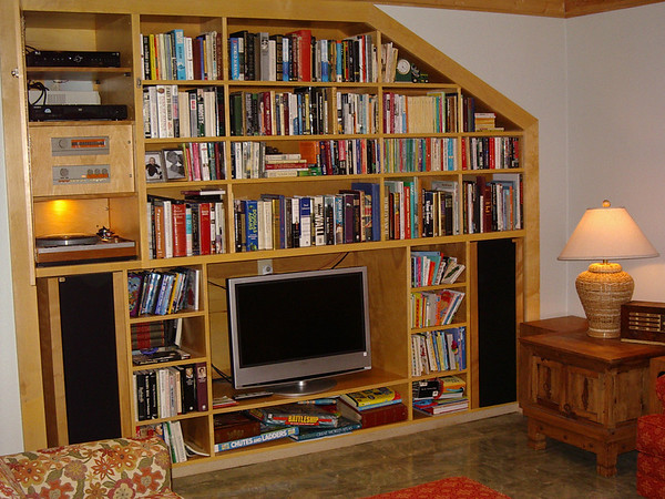

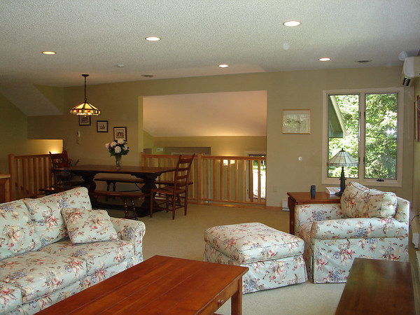

I will dwell a little on form and function.
When the remodel of our home at Benedict was almost complete, my wife took exception to this room unit of the split air conditioner. It is visible top right.
She wanted to know if it could go or be disguised. This area can hold a lot of people and has a big heat load from cooking.
So my daughter, who was the architect and interior designer, had to explain to my wife, that that area had to have a boost AC unit for times of exceptional heat load. Further that a unit is what it is, and would not be an unexpected fixture, and therefore not detract from the space, but enhance it, because it makes the space comfortable. You can make the same argument for speakers and AV systems in general if tastefully done. As an aside I would make the comment that, that space if totally unsuitable for AV equipment of any type.
In a dedicated space for audio and video, the problems I agree are different. Obviously this is because the reason for creating the space is for listening and or video. So the equipment has to integrate with the space and be continuous with the space. Despite containing a lot of equipment, even non technical listeners find this a beautiful space, large speakers and all.
Multipurpose spaces need compromise and careful integration of AV equipment with the decor and uses of the space.
This subject of form and function is complex. The issues are not usually handled or solved well by interior decorator types.
