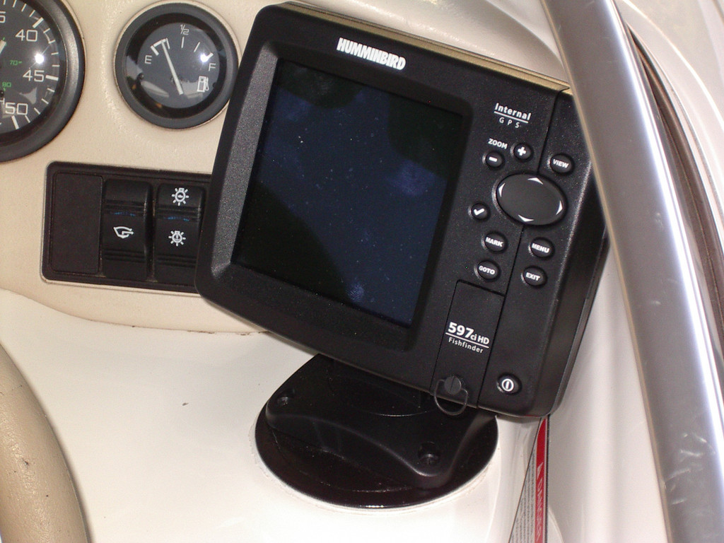

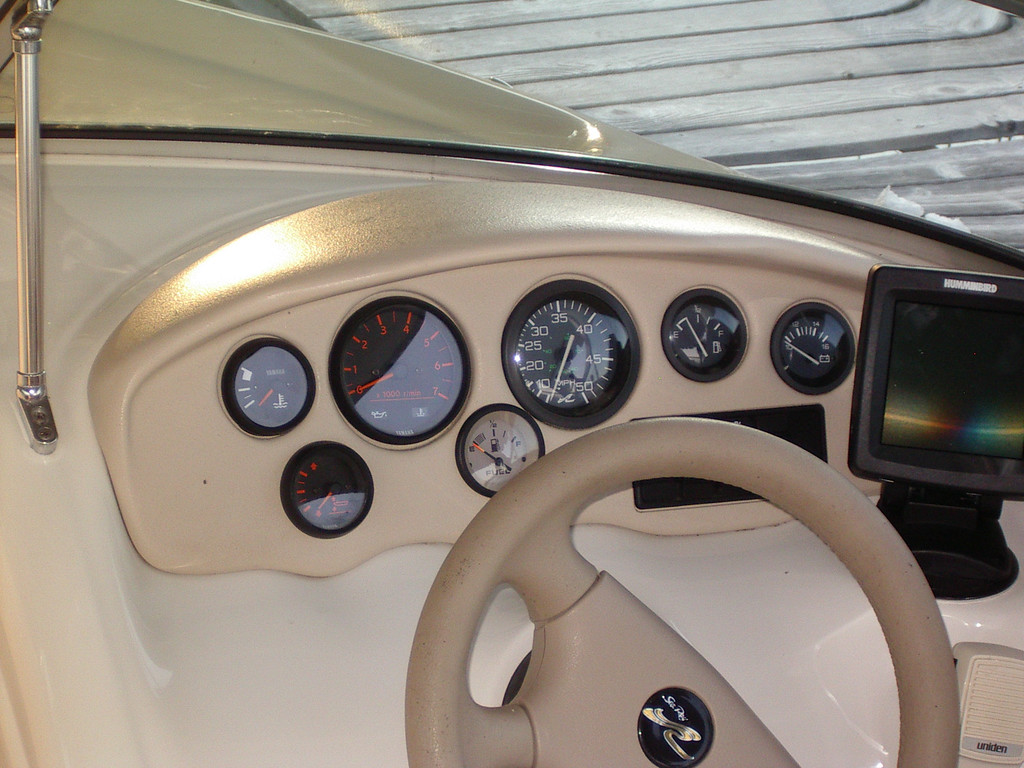

We added a 12 gallon fuel tank, added gauges and installed the marine band radio and GPS.
I was proud of the GPS installation and converted one of the cup holders as the base.

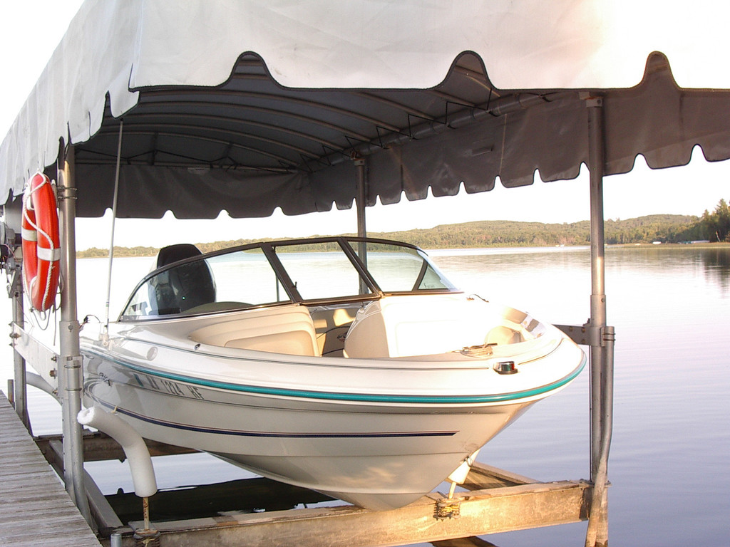

Here she is on my lift.
The new instrument cluster.
