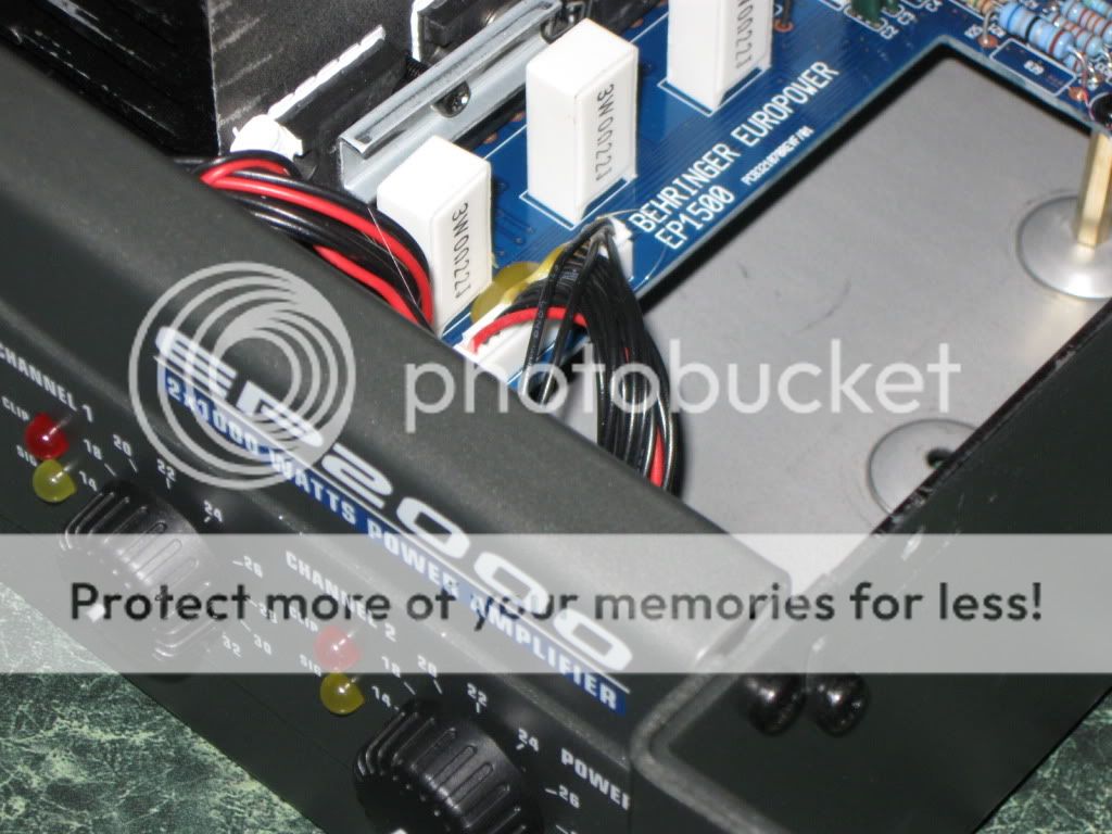

So I finally received my EP2000 at the price of a 1500 because I ordered the 1500, they were out of stock and the 1500 is discontinued so they offered me the 2000 for the same price. Yay!

Oh, and I did the fan mod....IMMEDIATELY. No way I was going to live with that stock fan.

It's only fair they sell the EP2000 for the same price as the EP1500, it's the same amplifier. The EP3000 is the same as the EP2500 as well.
