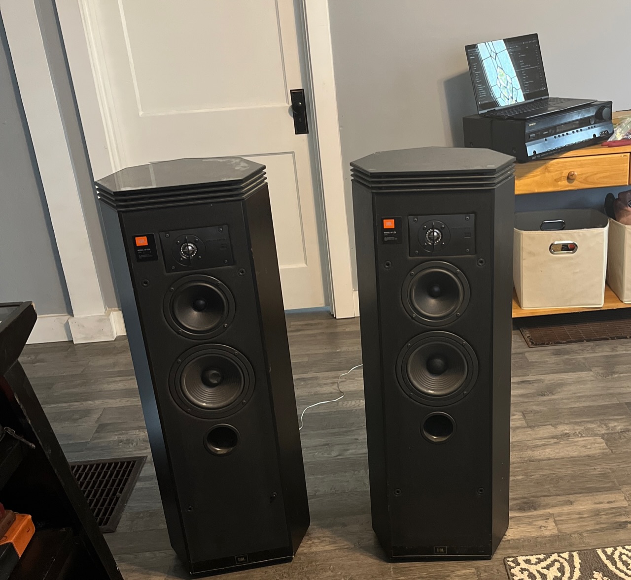

Hey all! I am new to the audio scene but have been wanting to get some towers for a while. I ended up finding some JBL HP 530s. I’ve had a great time finding much info on these at all. They sound pretty good with an older Onkyo amp I had around but I’d like to level up the setup. I’ve ordered banana plugs and new 12 gauge wires which should be more than enough. Previous owner was using 22AWG. I’m wondering if I’ll be able to hear a difference. Does anyone else have a set of these and how did you end up setting them up? Also they need a little love cosmetically so I’m open to tips there too! Thanks!

Dust cap has been pulled. Can’t leave them looking like that.

Hey all! I am new to the audio scene but have been wanting to get some towers for a while. I ended up finding some JBL HP 530s. I’ve had a great time finding much info on these at all. They sound pretty good with an older Onkyo amp I had around but I’d like to level up the setup. I’ve ordered banana plugs and new 12 gauge wires which should be more than enough. Previous owner was using 22AWG. I’m wondering if I’ll be able to hear a difference. Does anyone else have a set of these and how did you end up setting them up? Also they need a little love cosmetically so I’m open to tips there too! Thanks!View attachment 62320
Where did you find those? They are very rare. They date from the early nineties and were made in Denmark and may be Hamburg as well, but certainly Denmark. They were for European consumption mainly and I think most sold in Germany. I do not know who actually made those speakers.
