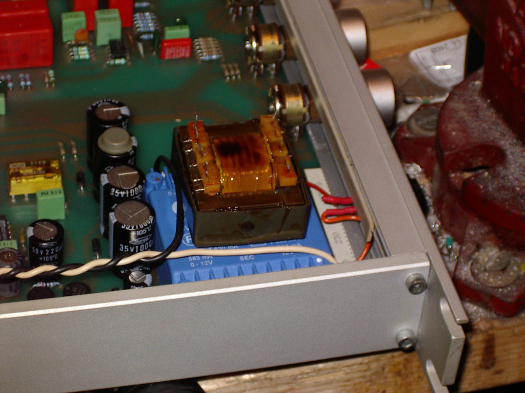

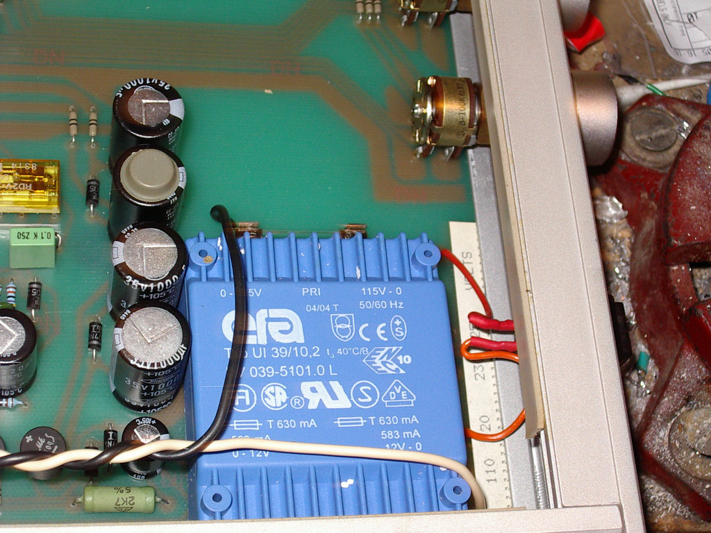

Here is his preamp showing a pretty cheap burnt out power transformer. Now a preamp does not take much power and to have a power transformer fail at anytime during the life of the unit is really in for a dig.
I refused to use an OEM replacement as the transformer did not meet by standards, even if it met theirs.
Here is a picture of their cheap burnt out transformer on top of the high quality unit I modified the unit to take.
Here is a picture of my mod.
