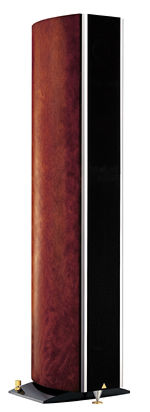

I know one of the guys making the Triangle Magellans and no, 2 Ohms is not below the combined resistance of the drivers and they are with the exception of Quad ESLs combined with Finnish dipole subs the by far best sounding speakers I have heard and owned. Belden and Parts Express is not really an option in Denmark (duty/tax is a deal breaker) ;-)

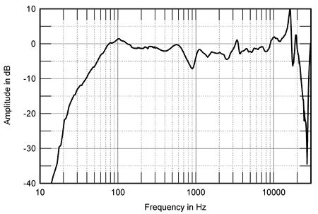

That's the impedance chart from Stereophile's review of your speakers. I gotta say, based on their findings I'm not so sure I would agree with you. They appear to be inaccurate and extremely- unreasonably hard to drive. I would very much like to listen to them and hear for myself, but my first impressions based on specs isn't very good...
The Triangle was one of the more sensitive speakers I have encountered, its B-weighted sensitivity clocking in at an estimated 93dB(B)/2.83V/m, which is well above average. It might be thought that this would make it suitable for use with low-powered or single-ended amplifiers. However, the speaker's impedance plot (fig.2) reveals it to be a horrible load for the partnering amplifier. The impedance magnitude remains between 2 and 4 ohms over almost the entire audioband, and there is an amplifier-punishing combination of 3.7 ohms and a 44 capacitive phase angle at 78Hz. An amplifier capable of hefty current delivery is going to be a must with this loudspeaker.
Even his subjective comments felt to me like he was reaching for positive things to say.

So I assume you are talking about the Triangle Magellan concerto.
I see four woofers. The spec. is minimal impedance 2.5 ohms. So that could be above the paralleled DC resistance of the woofers. That sure restricts the choice of amplification to say the least.
View attachment 36325View attachment 36324
I know the Stereophile review very well. It's 15 years old and from a pre-production or the very first series of the speaker.
Verified by REW measurements I have a very linear response 15 Hz to 12 KHz in my room, above 12 KHz the response rolls off slightly. Some of the roll-of is due to acoustic treatment of the room which also keeps the room's otherwise generally unpleasant decay under control. The Magellans are helped by dual B&W ASW800 subs with a crossover set at 60Hz.

Yeah, I realized I was being kind of douchey beating up on your speakers after I made the post. I've never heard them so I really don't know how they sound in any setup. For all I know they might sound amazing, but just be very difficult to drive.
Based on the measurements your observation that they sound very high makes sense tho. I know not all speakers are designed to be perfectly accurate and some aim for certain colorations that some find more appealing than a flat, accurate speaker. There's nothing wrong with that.

OMG no, that is the Grand Concert which cost something like 25 times what I paid for the Concerts ($290.000,-/set versus $32.000,-/set list prices versus the §11.000,- I paid)
