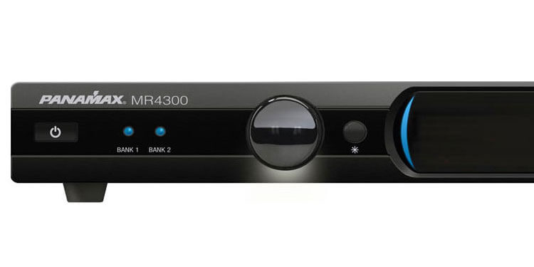

I agree with you. If you own a house, the whole house surge protection system is the best protection. If you live in an apartment like I do, then a Panamax or an APC power conditioner will do the job. I use an APC H15 and that provides adequate protection. It even stabilizes the incoming voltage as it has trim and boost features which are useful for wide voltage variations.

I forgot about the folks who don't own their own homes ! I apologize. If you're not in a place with your name on the title, then power conditioning equipment makes the best solution. I have an APC UPS system for my computers and then some similar stuff on the music room. I don't see enough problems during a year to justify a whole home surge protector.
