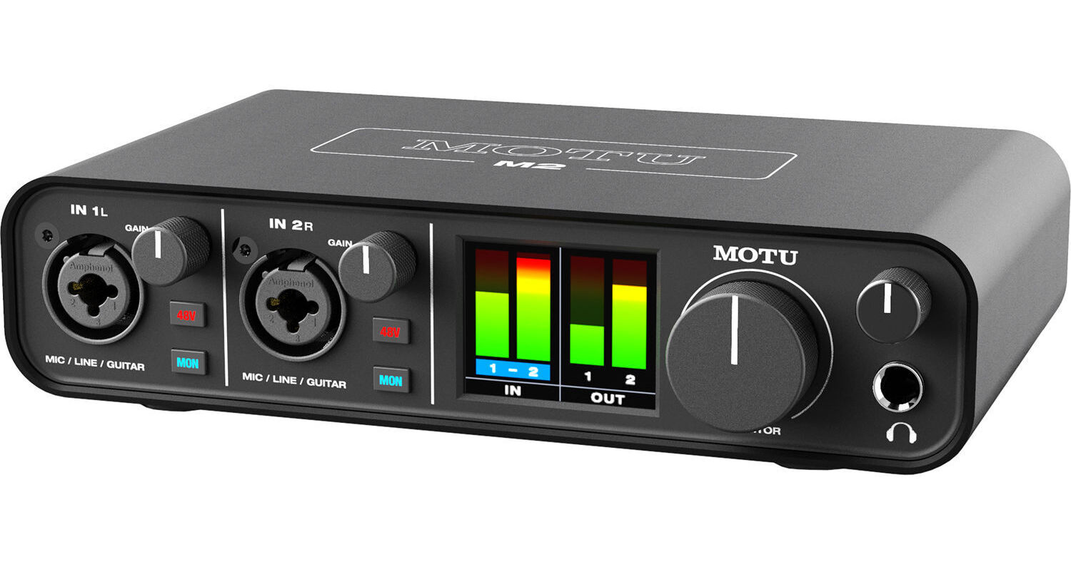

just not simply buy a pair of these:
and then use this to control the sound:
Return the speakers and Denon (*depends if your Denon receiver has analog pre-outs for more than just a sub, you may continue using it)

@Tim Brayton, I am curious as to why my prior suggestion of Kali monitors was ignored?
They aren't great looking but would provide you plenty of both volume and sound quality. (@shadyJ Reviewed them and found great value) Balanced cables could be run quite far if needed. As I could see only thing missing in that setup you'd miss is the remote control.
