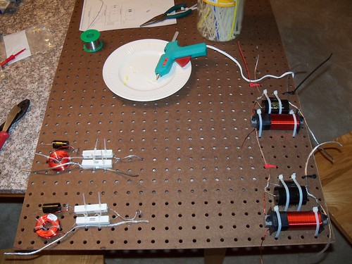

I'd like to ask what the proper adhesive would be to mount these parts, but I'm pretty sure Alden's book might tell me, which I have just now ordered as that was recommended by Swerd in yet a different thread. That should really help limit the number of unnecessary and stupid questions I might ask.
I attach the crossover parts to a thin board (¼" thick pegboard) with nylon cable ties. Then I use a few screws to attach the board to the cabinet interior. No glue, no mess.
You mean like this :)

The rounding over of the baffle helps with diffraction loss. So it is more than cosmetic.
Rounding over the cabinet edge helps smooth out small peaks and dips in the frequency response in the mid to upper treble range. Read this small entry by Dennis Murphy. It describes how a 3/4" round over on the cabinet edges of a small 2-way speaker helps smooth out a small peak at about 4 kHz and a small dip at about 7 kHz. The differences are clearly visible in his frequency response curves made from speakers in cabinets with and without the roundovers. The question is, of course, is this difference audible? That's harder to say. Dennis has the opinion that if a speaker's frequency response can be made measureably smoother without great expense, like using rounded cabinet edges, then why not do it. It seems that a 3/4" radius round over is good enough.
