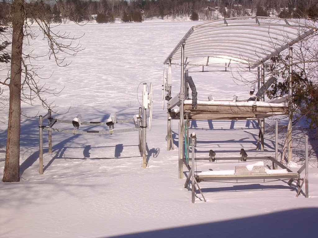

I have not had time today. I just got back to Benedict lake late yesterday afternoon, after my second cataract surgery last Friday. In the week I was away we have lost about a foot of the 33" snow pack we still had when I left.
Today we had a strong SE wind in the mid forties increasing the melt. However the culverts on my private road are blocked with ice and large snow pack. There was a huge lake forming at the 2 ft diameter culvert threatening a sudden road wash out, and water starting to flow over the road at another. My neighbor had to have another two coronary artery stents placed last Thursday and is also useless at the moment. The other residencies on the road are seasonal residencies.
So I have had to organize getting the snow banks excavated out of the culverts and the culverts steamed. So far we only have the large culvert open, and it is flowing white water at the moment.
We have had a massive series of snow falls here this winter with no thaws at all until about 10 days ago.
The old JD Model A has worked really hard this winter. The snow also has a huge moisture content and the old girl made one hell of a racket from her two huge cylinders.
If I forget to get back to this issue remind me. My priority at the moment is preventing road washout, as I have a lot of money and especially time on the two JD tractors invested in this road.
