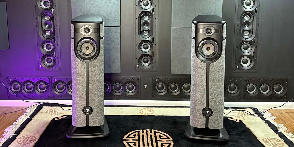

Yeah ... these speakers looks as cool as cool can getDesigning a speaker like this is a step in the right direction.
The specs are somewhat sparse, as the crossover frequencies are not stated.
However, clearly the bass drivers must operate below the transition frequency, or the deign could not work. The dimensions are not in the spec. but you can take a good guess that the width is around 10" which gives a transition frequency a little above 400 Hz most likely.
This is where are part company with so many speaker designs. The power requirements for the bass are grossly over estimated and the power required for the mid range grossly under estimated. So we have 250 watts to the bass section and only 75 watts to one single mid driver.
Now I am sure you can get superlative standard measurements from these speakers. However when you listen to a full orchestra and now throw in a large chorus, the mid range is going to be grossly underpowered.
I know because when working with files of all kinds of music most of the power is is between 250 Hz and 2.5 KHz. That is where the power continuously peak and by a a huge margin.
That is why I make very different choices in my designs, and that means my speakers can really reproduce the major large forces works a concert volume without distress and realistically.
If the bass of the speakers need 250 watts, then the mid range needs at least as much and that likely requires more than one midrange driver.
Reduction of heat vs necessity to drive to a specific SPL would be my guess? The tweeter won't require anything from an amp relative to the rest of the drivers, and even then their draw could be small. With DSP crossovers it's easy to maximize power.Yeah ... these speakers looks as cool as cool can get
but I seriously wonder about that possibly underpowered amp sections....
I am using 2 x 600 watts toward s small set of Dunlavy designed standmount speakers (and I have other speakers too) and find that to be exactly what I need. that big amp really makes those small speakers sing way more
So why is Focal not providing insane excess power to a $40.000 speaker.
I love the design of those speakers, what I heard from Focal is great, the beryllium tweeters are also something else, but having possibly not enough power?![]()
You may be very correct!Reduction of heat vs necessity to drive to a specific SPL would be my guess? The tweeter won't require anything from an amp relative to the rest of the drivers, and even then their draw could be small. With DSP crossovers it's easy to maximize power.
I haven't auditioned the.either, I'm just speculating based on many other active designs not having "excessive" power on demand for all the drivers.You may be very correct!
I didn´t audition them yet .... so I may be completely wrong!
guess, Focal knows really well what they´re doing!
I am gonna try to see if it is possible to audition ... and report what I think, in hereI haven't auditioned the.either, I'm just speculating based on many other active designs not having "excessive" power on demand for all the drivers.
I hope to see more active designs appear for the residential market but this hobby is teetering unfortunately.
