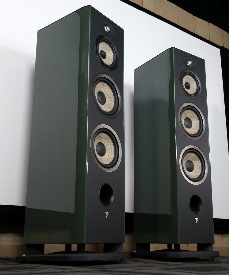

Our last encounter with Focal’s Aria line was in our review of the Aria K2 936 Floor-Standing speaker. We liked that speaker’s neutral tonality, wide dynamic range, and bold styling. Focal recently refreshed their Aria line with the ‘Aria Evo X’ series, and we were curious to see what improvements have been made, which brings us to today’s review of the Aria Evo X No.4. As the name denotes, the Evo X series is an evolution not revolution, so what we expect to see is basically a refresh and updating of the existing designs with improvements in technology rather than a top-down redesign. Such improvements would only make a good speaker even better, since the Aria series already has a fundamentally good design. In this review we ask the questions: how much has Focal improved upon the Arias with this refresh? Are the changes merely cosmetic? How does the Aria Evo X No.4s stack up against other speakers in this highly competitive market segment? Read our full review to find out…

James thanks for your latest review. That green does look sharp especially with the flax cones. My daughter the interior designer would approve. Different from the usual offerings as you noted.

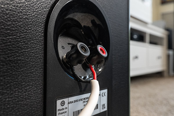

Nice review on what seems to be very nice speakers. One observation I had from the pictures were the binding posts. Are they as cheap as they look? They look extremely budget.
Eppie
Eppie
SoundAndVision has a close up of the binding posts in their review:
