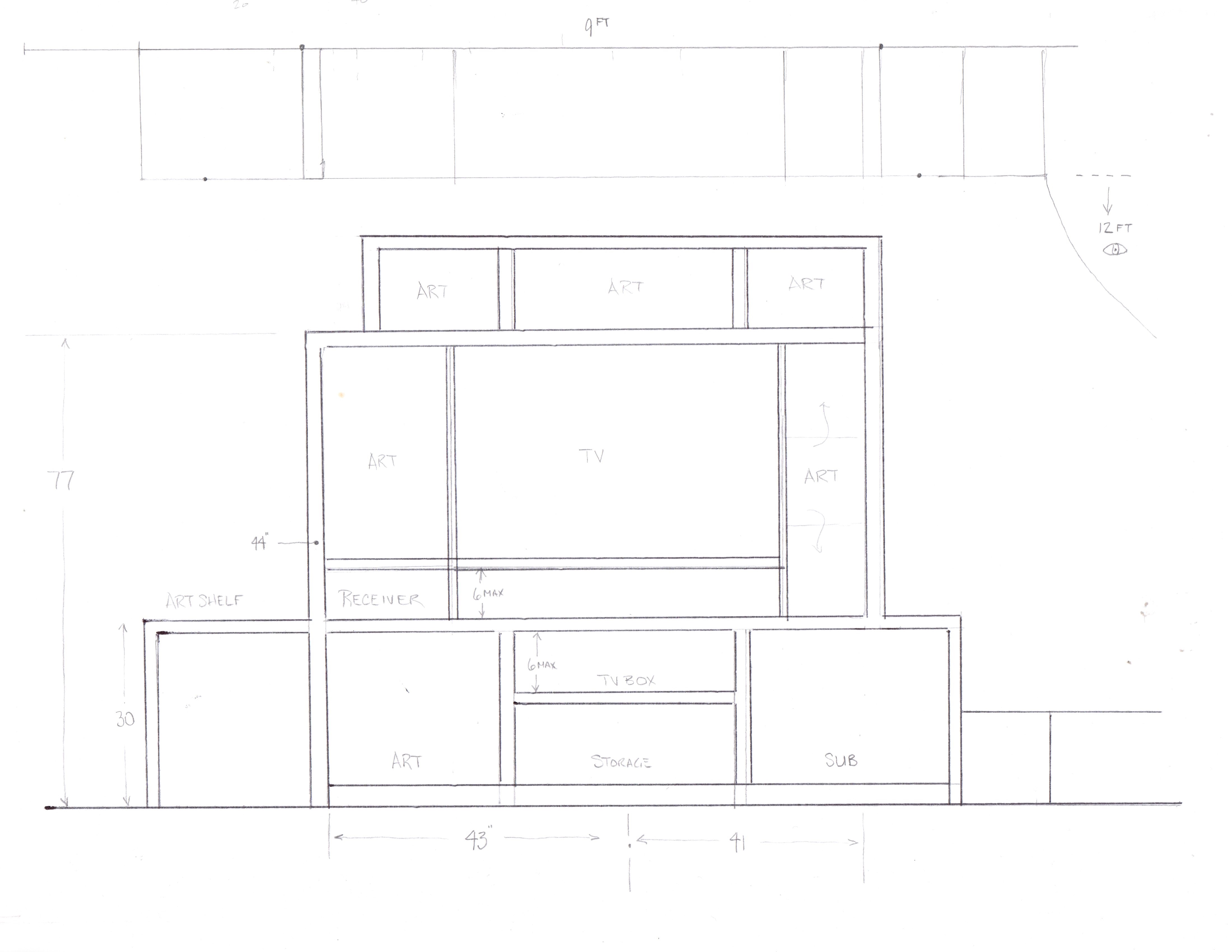

Can you put a picture on like photobucket, that would be useful to see. If you have enough posts you can upload directly from your computer.

Adam D'Agosto
Ok great idea. I will map it out for you. Let me work on this.

Ok. Here is what my entertainment center looks like face on. The center seat is 12 feet from the TV (55" Panasonic plasma).
The bookshelves where speakers could go would be directly below the TV in the 6" tall section. That's about 51" wide or so. The mains could go inside the bookshelf just above where I have the Receiver shown (even though I don't have one there). That's where I would want to place it. Reason: the other good place for it would be the 6" tall section with the TV box. The problem is, it is ONLY 6" tall and only slimline receivers will work. BUT, the problem with this is, the speakers would be higher than optimal and the very bottom of the bookshelf speakers would be about 44" off the ground (my ear height). In this case, the tweets would be kinda high. Soooo, another place for the mains would be hanging on the OUTSIDE of the entertainment center. You see where I have that little dot with the 44" dimension? That's about there I'd place a bookshelf speaker. In this case, I could get the tweeter right on target. The 30 degree left and right points are VERY close to where that dot is drawn.
The lower right section where you see "sub", that's where my current sub is for my Bose 2.1 CineMate II. That should work.
The room is 26 feet wide (right to left as you look at the image) and 22 feet deep (direction of the speakers). BUT, that 22 foot dimension opens up the the kitchen and dining area and that adds another almost 30 feet. The ceiling is almost 18" high.
With all this now, I guess the question for you is, where would you put the mains? Is having a extra long center channel advantageous here or is something simple like a DT ProCenter1000 all that's needed?

Can you just chuck the entertainment center? It really is quite awful and puts your system at a big disadvantage. The diffraction effects of being placed near all that shelving make for poor acoustics. It badly restricts placement as well, and the speakers are likely going to be too close to each other. Wiring everything up is going to be a major pain. There is also the problem of properly ventilating the amplifier and other electronic components. It destroys the audio just to have shelving for knick-knacks. I say tear it down, pile it up in the backyard and destroy it with a flame thrower. Replace it with a light and loose entertainment shelf like this. You will have room for a real audio system, and if the wife complains, turn the music up louder so she can't be heard over it.

ShadyJ, I completly agree. I hate the stupid asinine cubby design. In fact, when we got the new TV, we actually gutted 2/3rds of it and replaced it with custom adjustable shelves. It looks a million times better.
That said, you are still right about everything you said, except for the part about the wife. She saw me pulling dimensions and said, "Your not planning on destroying the entertainment center..."
You did mention you thought the mains would be too close to each other. I don't know if I agree. I see that if I mount speakers to the OUTSIDE of the entertainment center (along the 77" dimension line), I can get the mains out to 30 degrees separation. They would be 9 feet apart and 12 feet away.
I'm thinking a lot about the Definitive Technology ProMonitor1000 and ProCenter1000 along with a ProSub1000.
Thoughts?

If I were you, I would be looking at narrow dispersion speaker designs, not wide dispersion designs. They will still be adversely impacted by being placed in a enclosed cabinet space, but not as much. Look at designs with horns or serious waveguides. I would be looking at Klipsch speakers, Hsu speakers, JBL LSR speakers (if your AVR has pre-outs). Place the speakers so their edge is flush with the edge of the shelving. You do not want the speakers recessed back into the cubby.
If you can get the main speakers apart from each other where they form an equilateral triangle with your listening position, that is the ideal.

I'd place them 10-12' apart. Any narrower and you have severely compromised imaging.

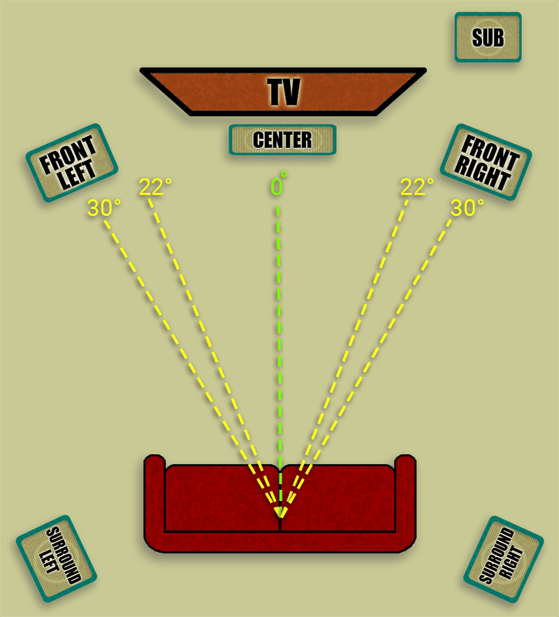

Basically, yes. Most speakers sound best with a good standoff distance away from nearby surfaces. Placing them inside of a cubby is nearly the opposite of that. Here is a picture that would serve as good general placement advice- see how far the speakers are from the walls, and their angle with respect to the listener:
