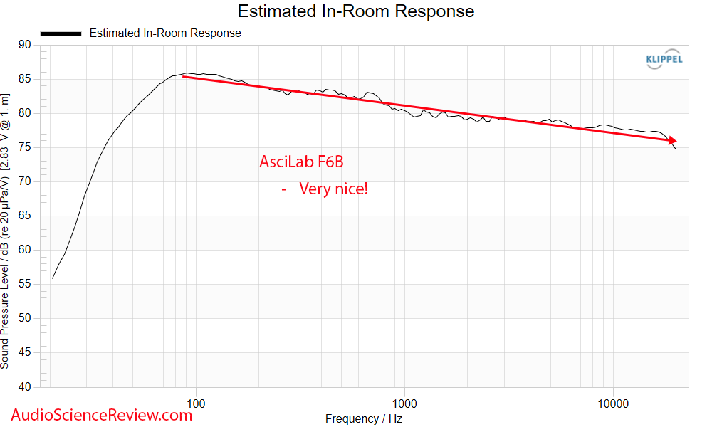

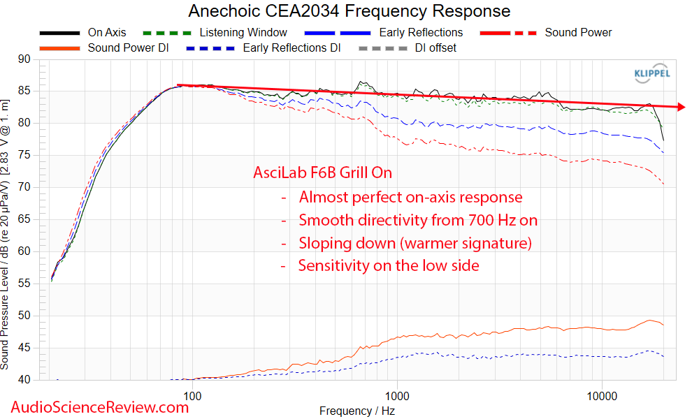

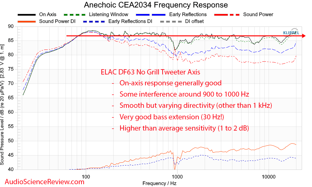

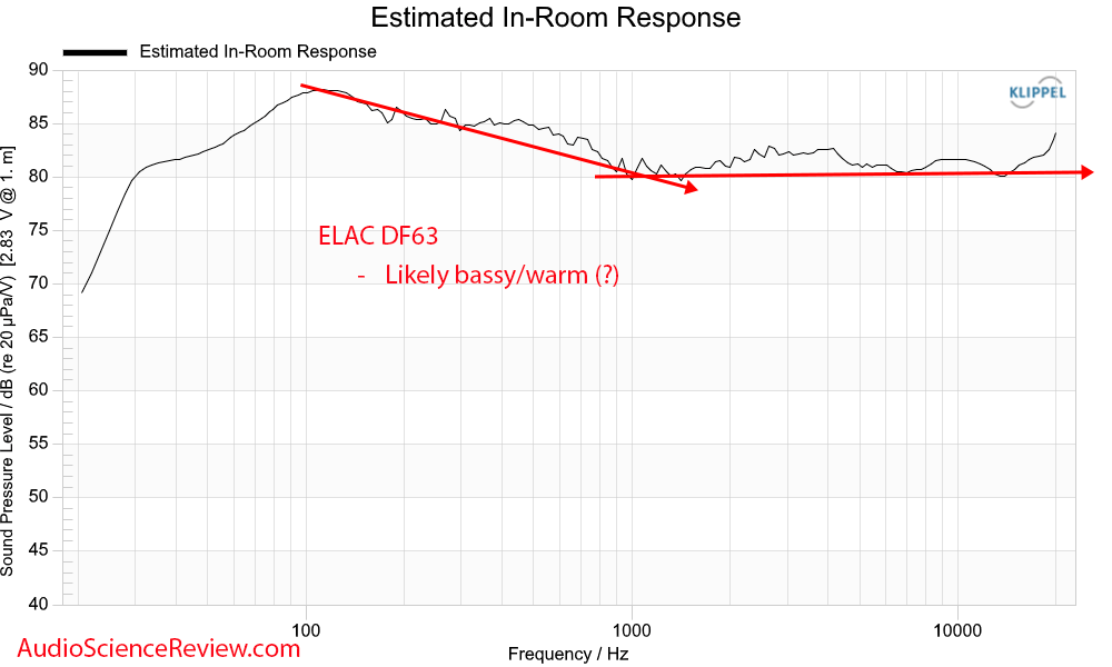

The downward tilt in in-room measurements shows the physics at work: The amplitude reduces as frequency increases. High frequencies have increasingly smaller wavelengths that naturally attenuate, they're small and have less energy. They also keep getting smaller - every bounce off a wall doubles the frequency. Or is easily absorbed as everyone has said.
Flat In Room response would mean tremendously sharp sounding treble.
Flat anechoic response demonstrates that the speaker is not coloring the sound in any way and remaining neutral.
