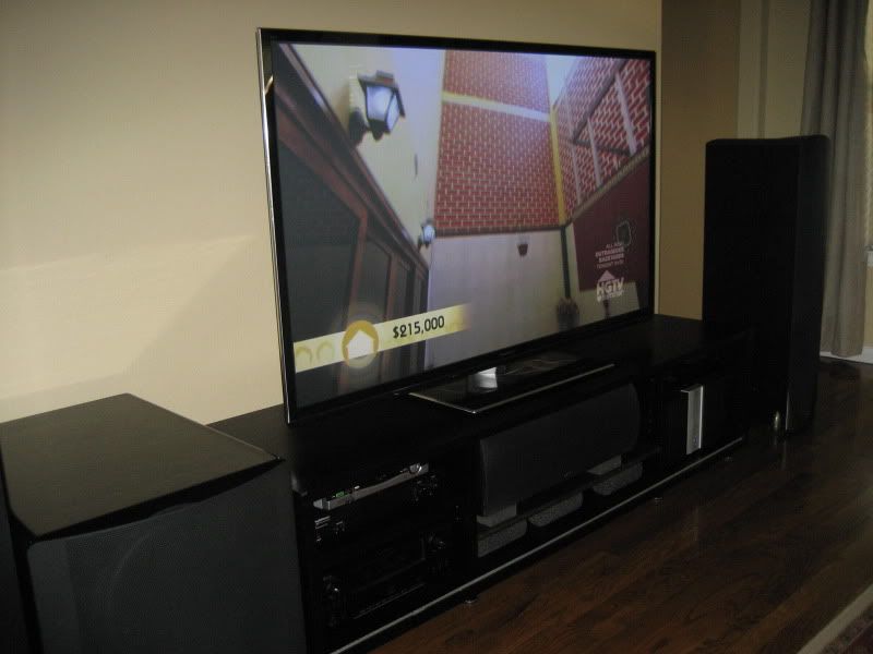

Hard call, you should let it slowly get up to room temp before plugging it in. On the other hand, I have a plasma outdoors on my patio and use it all year long and it's been going strong for 4 years.
BTY...I have a GT50 in my living room. Awesome TV, even in less than perfect light conditions.
