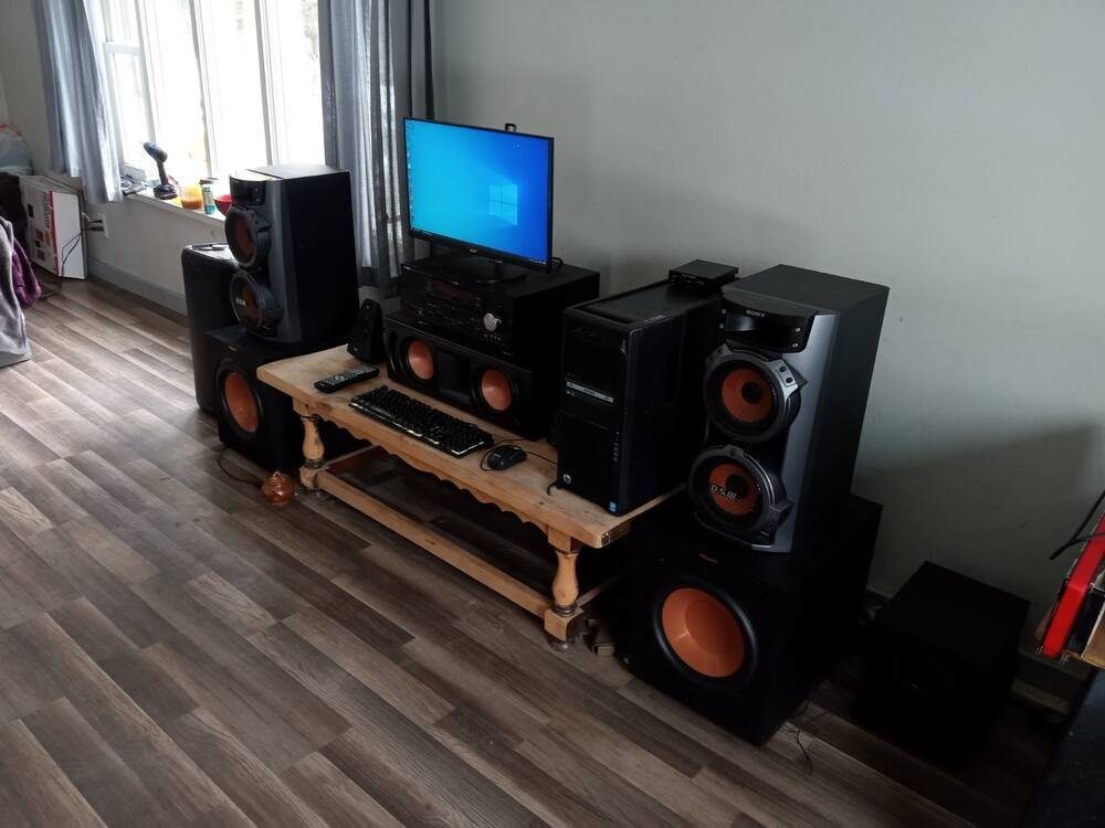

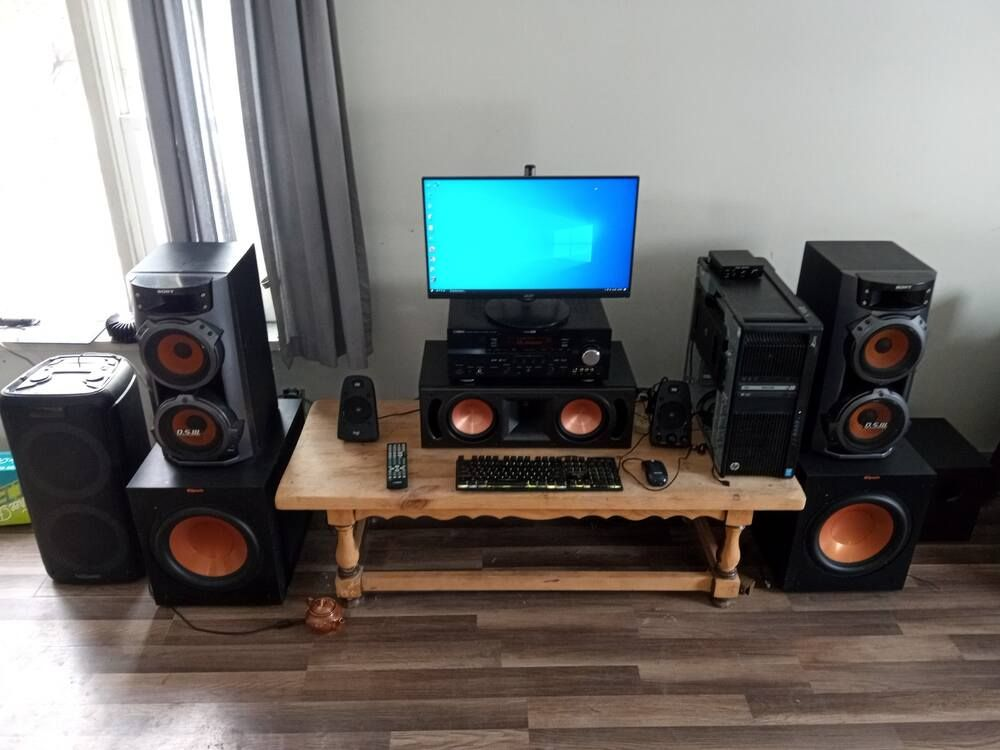

Very first audio build. Used to build computers fo a living so this was a natural segway I guess. I figure it will always be a work in progress so i'd like to get some feedback on what you think of it and what I might want to upgrade/improve at some point in the future. Sony speakers will be getting replaced eventually.
Yamaha RX-V863 400w A/V receiver
2ch Stereo Configuration
x2 Klipsch 12" reference subwoofers
x1 Logitech Z623 130w 8" subwoofer
x1 Klipsch RC-62 II center speaker
x2 Sony speakers for L and R (temp)
x2 Logitech THX satellite speakers
Purpose:
1) Media streaming
2) audio only for now
3) to piss off the neighbors :p

whats that big speaker to the left of your system beside a sub ??
We’re are the surrounds ? At? Model
Looks good those were some of the biggest sony shelf speakers made I think . I got the smaller duel woofer ones in my basement set up. Even if you’rs are temporary you got a decent starter system. I run Klipsch icon towers in my main system .

@Speedy-Sprocket , Welcome to the Forum. For a first build, it certainly is an interesting assembly of components. The Yamaha RX-V863 AVR was top of the line in 2008.
I'll try to help you with the layout, based on the photos. Try to put the Sony Speakers on stands so the tweeters are at ear height when you are seated, and try to have them at least 6-8 feet apart. You should notice an immediate improvement. (They appear too low mounted on the Klipsch Subs.) Are you using a "Y" splitter to feed the Klipsch SUBs via the RCA output on the AVR? (I wouldn't bother with the Logitech Z623 as it's for a PC, and not worth trying to integrate here.) If you want more low bass move the Subs towards (or in) the front corners of the room. I'm assuming the Logitech THX satellite speakers are part of the "combo" with the Logitech Z623 Sub. I have used a similar Logitech system on a Gamer Box (computer) I built for my son. (Yes, I build and repair PCs for family and close friends.) That Logitech speaker system has a built in amplifier in the Sub, which also powers the satellite speakers - via RCA plugs if my memory is correct. Those won't work with the AVR. So if you are eventually going to a 5.2 Home Theater system, you should be looking for better surround speakers. (Try Craigslist, Thrift Shops, Marketplace, etc. if cost is an issue.) Like the Sony's, the Klipsch center channel speaker is too low. Again try to get it to ear level, and not on top of the AVR, as it needs good air flow for cooling.

A couple of small points, Firstly spread things out, Get those small speakers on stands, and mount those sub's well away from the front speakers, and lastly buy yourself a large rug..

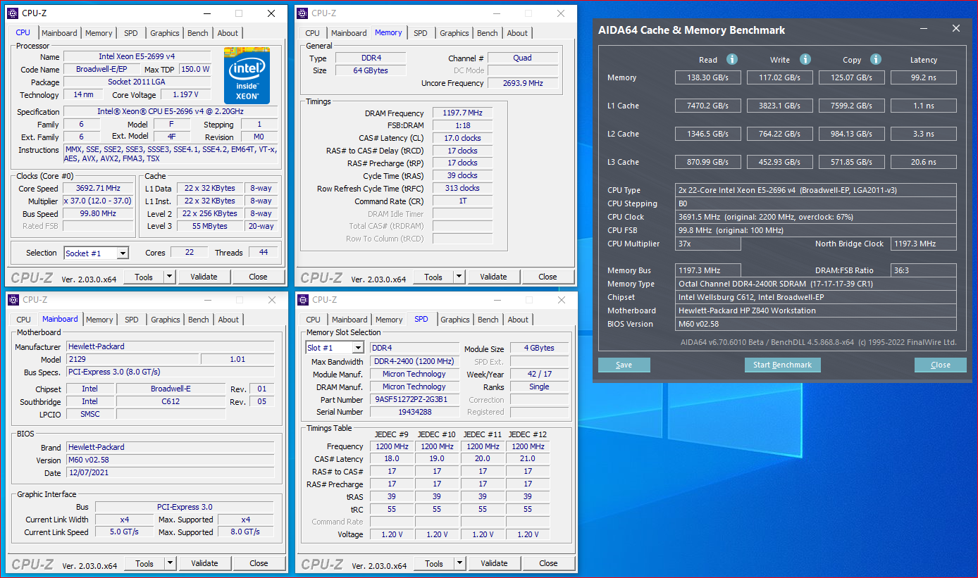

Interesting PC / Server specs, not current but probably overkill for just streaming Audio. You don't mention what video card you are using but I'd suggest you go from it via HDMI to the DVD input on the AVR. Then out of the AVR into your monitor. That way you will get the best audio quality. Especially if you ever want to play a Blu-ray image / disk from your PC.

I agree with those who have recommended speaker stands and better stereo placement. Also, do not put anything on top of subwoofers. Subs vibrate a bit when in action. Where you put them isn't as important as where you put the stereo speaker pair. The low frequencies are not very directional. Enjoy the music.
Its a portable speaker/subwoofer combo. Not hooked up to the main system, but could be easily enough.
sorry I missed this. It has a Radeon RX 5700 XT Gaming X 8GB GPU

@Speedy-Sprocket
Welcome to the AH ! There's a ton of good help and ideas here. The trick is to take a deep breath, relax, and enjoy the flood of opinions.
If I had to show you my first system build, well, I'd be embarrassed after seeing yours. Good job and putting together something that should work pretty well.
The most obvious ideas have been covered: spead it out a bit and get those speakers on some stands,
Also, since bass frequencies are largely location transparent, you don't have to have your subs up front.
You may find that by doing something called the "sub crawl" you will get better bass response at the listening position by moving them somewhere else in the room. Not a big deal and not a high priority here at the beginning of your journey.
