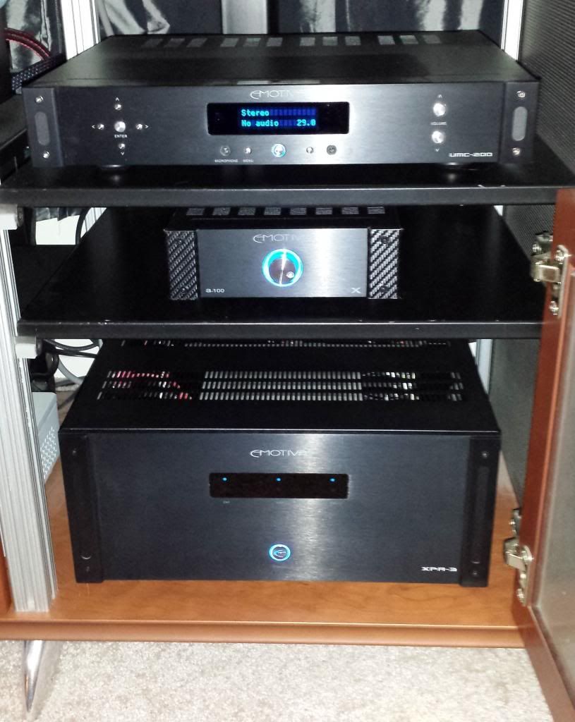

First pic of the new room

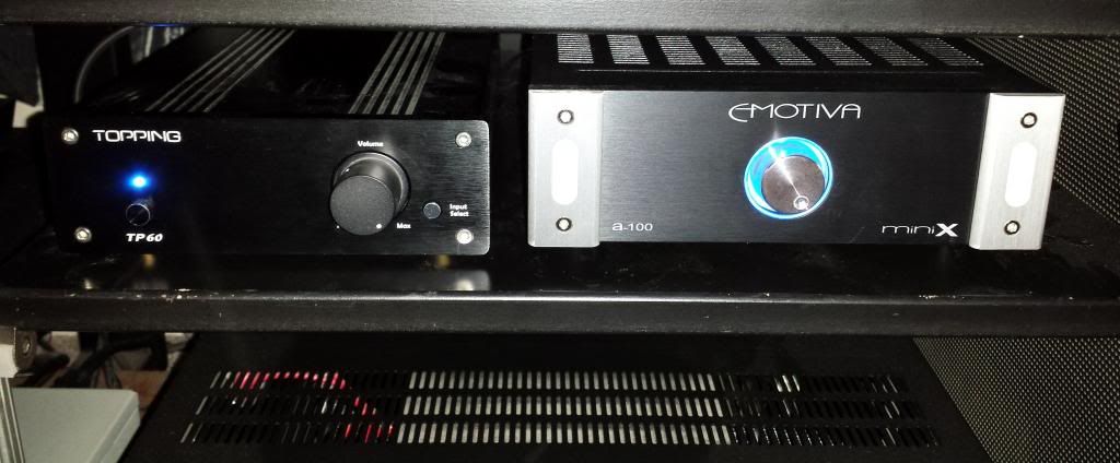

Swapped out the A-100 for the TP-60 so I can send the TP-60 back for service. I'm disappointed that it has an issue because I really like it. Occasionally when I turn it on, it does not come on, it just flashes and I have to turn it off and back on, sometimes a few times to get it to come on. It does the same thing on both inputs with different devices. It will work fine for a while and then start doing it again, so it is going back. The only thing the TP-60 lacks that the A-100 has is trigger turn on. It sounds very clean, is slightly smaller than the X-100, uses nicer binding posts, has a VERY solid extruded aluminum chassis, and a regular full size power cord. I may compare them side by side once I get it back from PE, but they seem to both provide plenty of power for my surrounds. A-100 rated at 50W, TP-60 at 80W. The TP-60 had no issues handling my older 4 Ohm A/V-2s at good levels.

This one was $150 new shipped, which is why I jumped on it :) I still have to configure the trigger, but for now it sounds great. I do think the TP-60 sounds cleaner, but for surround duty it is perfectly fine. My former surround amp was an Audiosource Amp300. Big, bulky and overkill for the surrounds. These two have no problem at all delivering more than enough power for the job and both take up less than 1/4 the space.

Something odd happened with the pic. Said it was in one folder but it wasn't, then when I viewed it, it was a completely different pic. So deleted and snapped a new one

Looks great. Can't keep up, but the 2nd shelf is the new one correct? Which receiver are you now using?
j_garcia
j_garcia
Top is the UMC-200. Center is the Mini-X A-100 for surrounds and bottom is the XPA-3 for the front stage.
