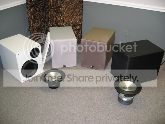

The Plus/2 is better IMO for the money. It's not as flashy in textured black, but you can't beat twin 12's with a 900 watt amp. That beast weighs 140lbs. I remember it putting out more air (in the rear ports) than my A/C in my truck. That sub was very impressive. The poor PB10 and 12 didn't have a chance after listening to the twins (not to knock the PB's - but it's like taking a spin in a Ferrari Enzo after getting out of a Honda S2000, and I love the S2000). If I had the room, I'd have the twins.
If you're going to spend that much on a sub, definitely spend the extra $200 and get a wood veneer. They are sooo sharp.

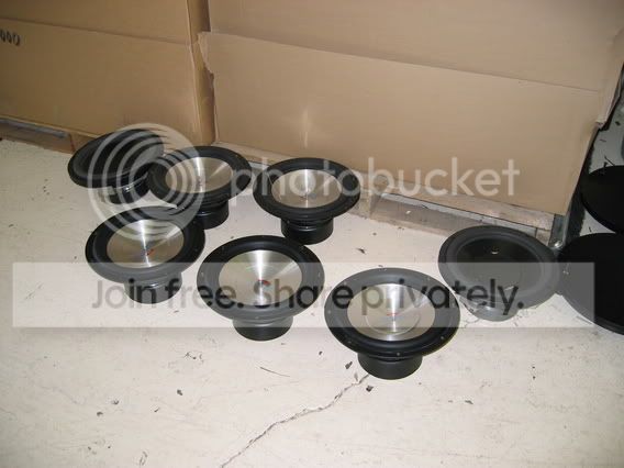

I was just tooling around the Velodyne website.
Velodyne uses magnets under 5lbs for their consumer subs, and then - bam, they surge up to 24lbs with the high end subs. We're talking SVS Ultra driver material. Unfortunately, the Velodyne 5000 has the smaller magnet. I'd still want to hear the unit, as the PB10 and PB12 magnets weren't all that massive. Nothing is going to beat a live demo, especially in house.
