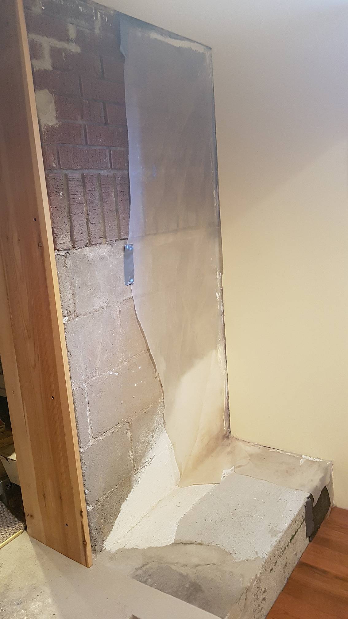

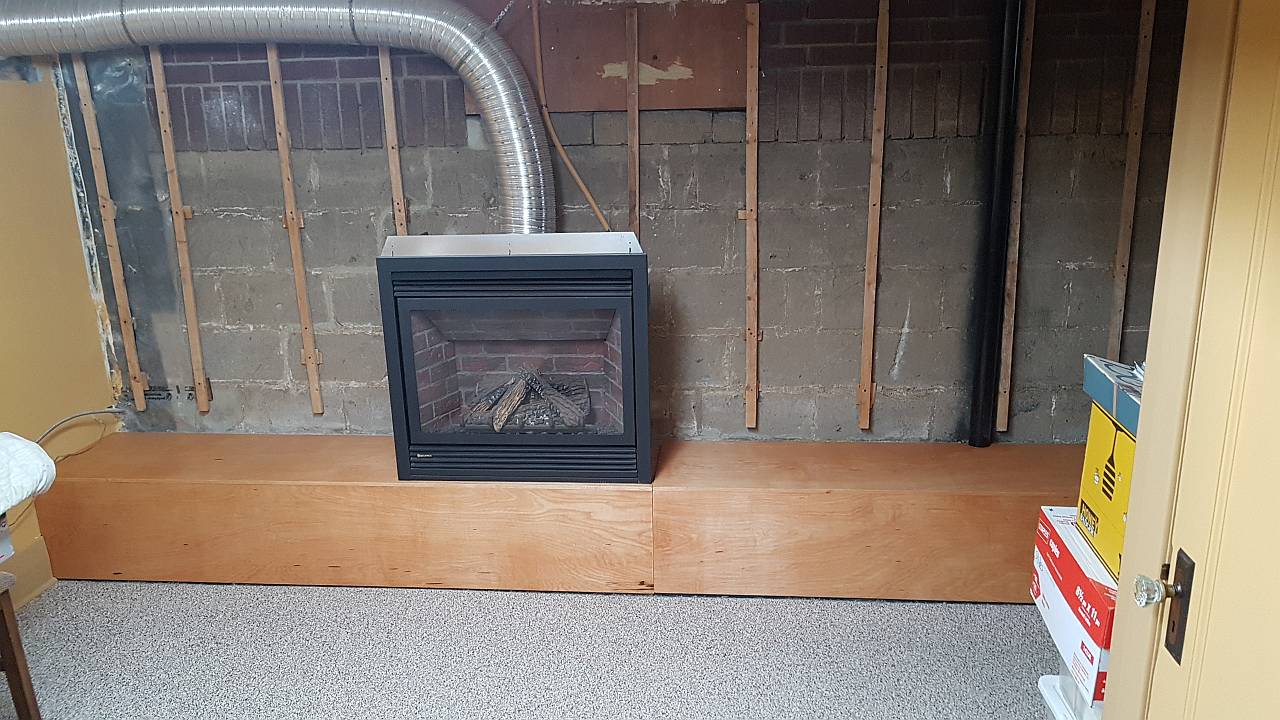

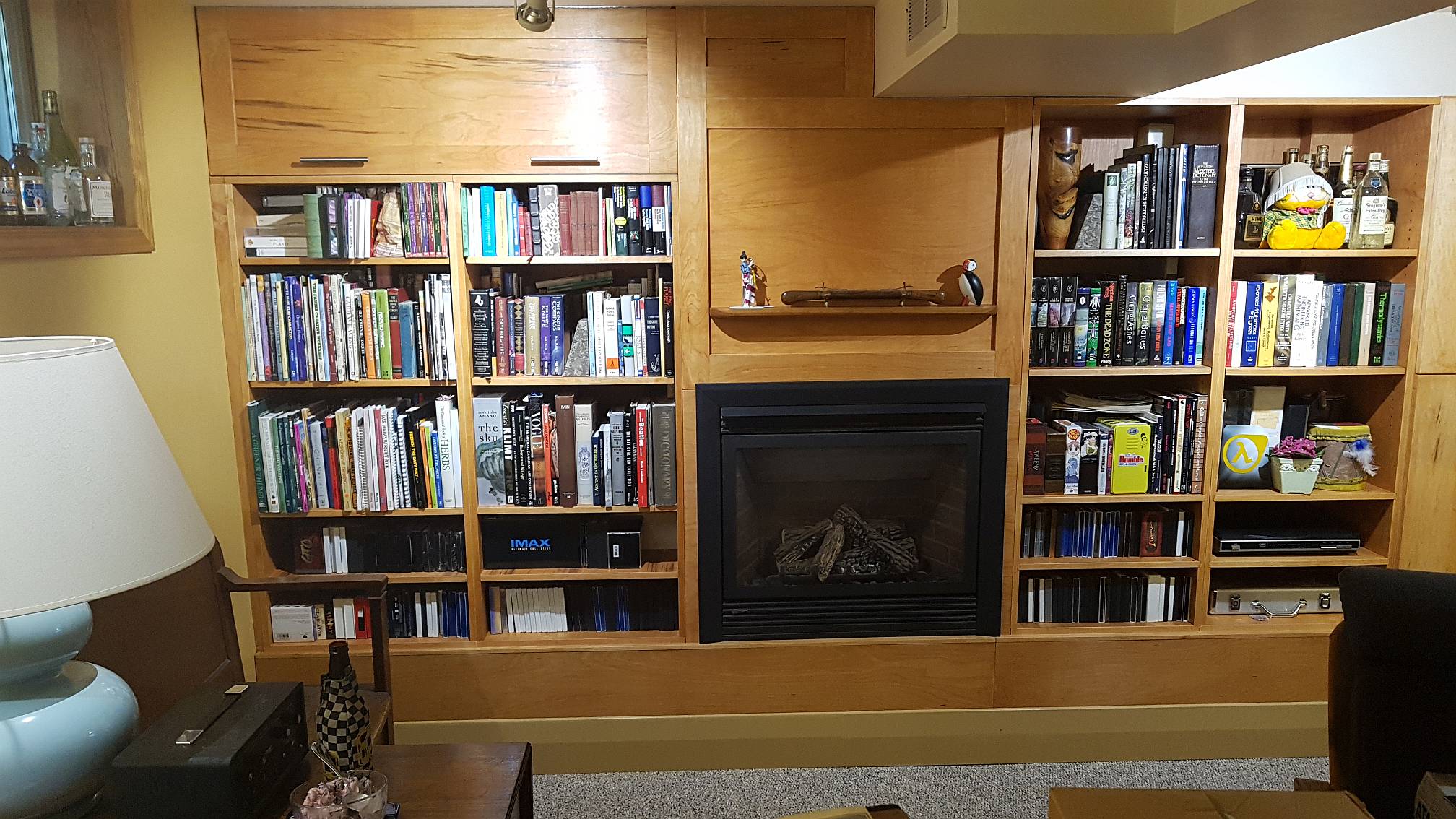

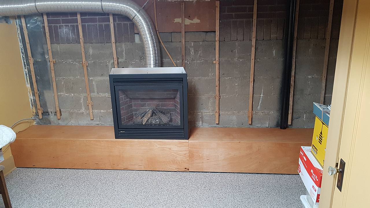

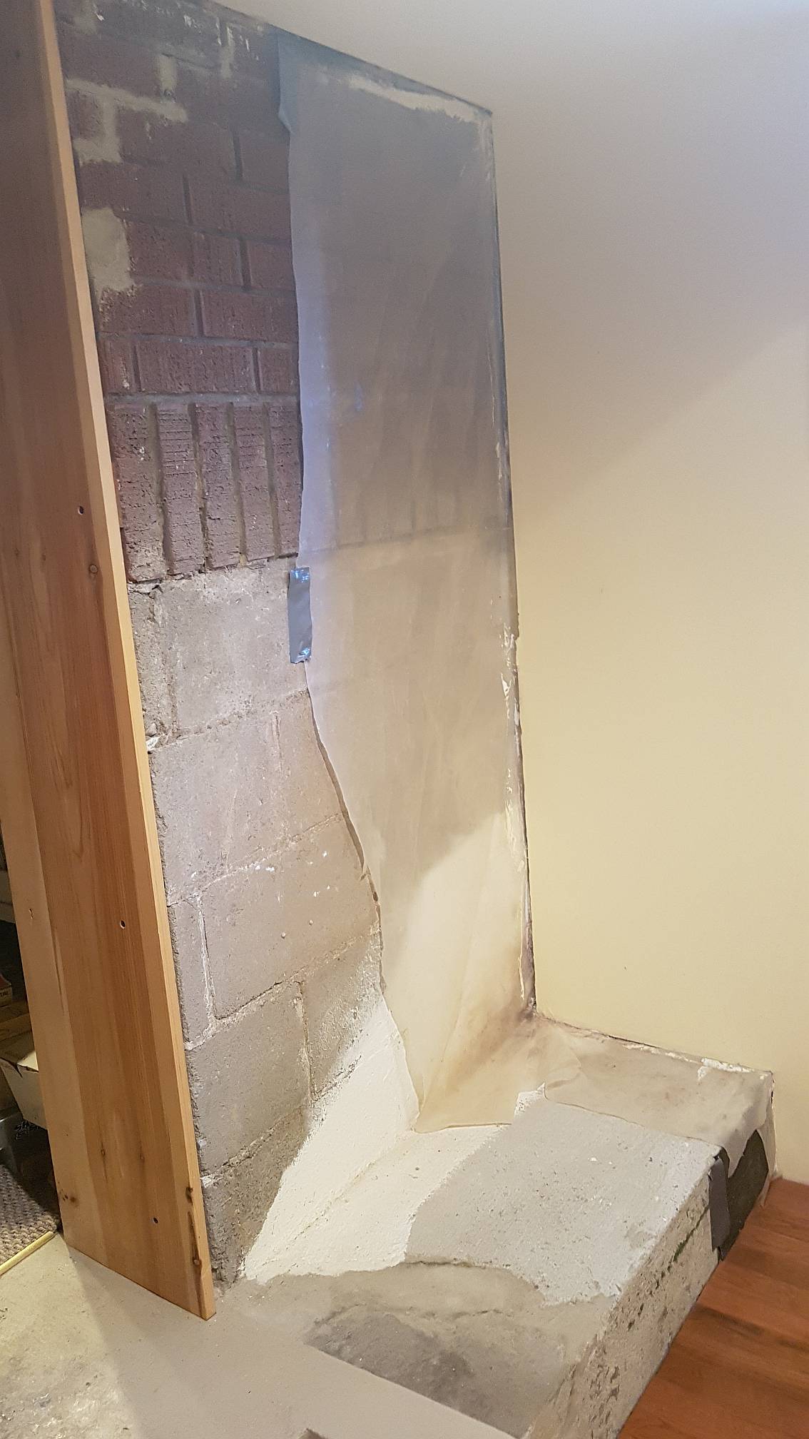

Not an audio update but a room update. The home theatre room is in the basement of an addition. The original house has a utility basement so the floor in the addition is deeper. That necessitated an 18"x18" concrete bulkhead / retaining wall below the old footings to support the soil. My plan was to cover it with a wall unit. The quote from a local cabinet maker came in at over $10k (and that was years ago before prices spiked). They do great work but over my budget. Decided to do it myself.

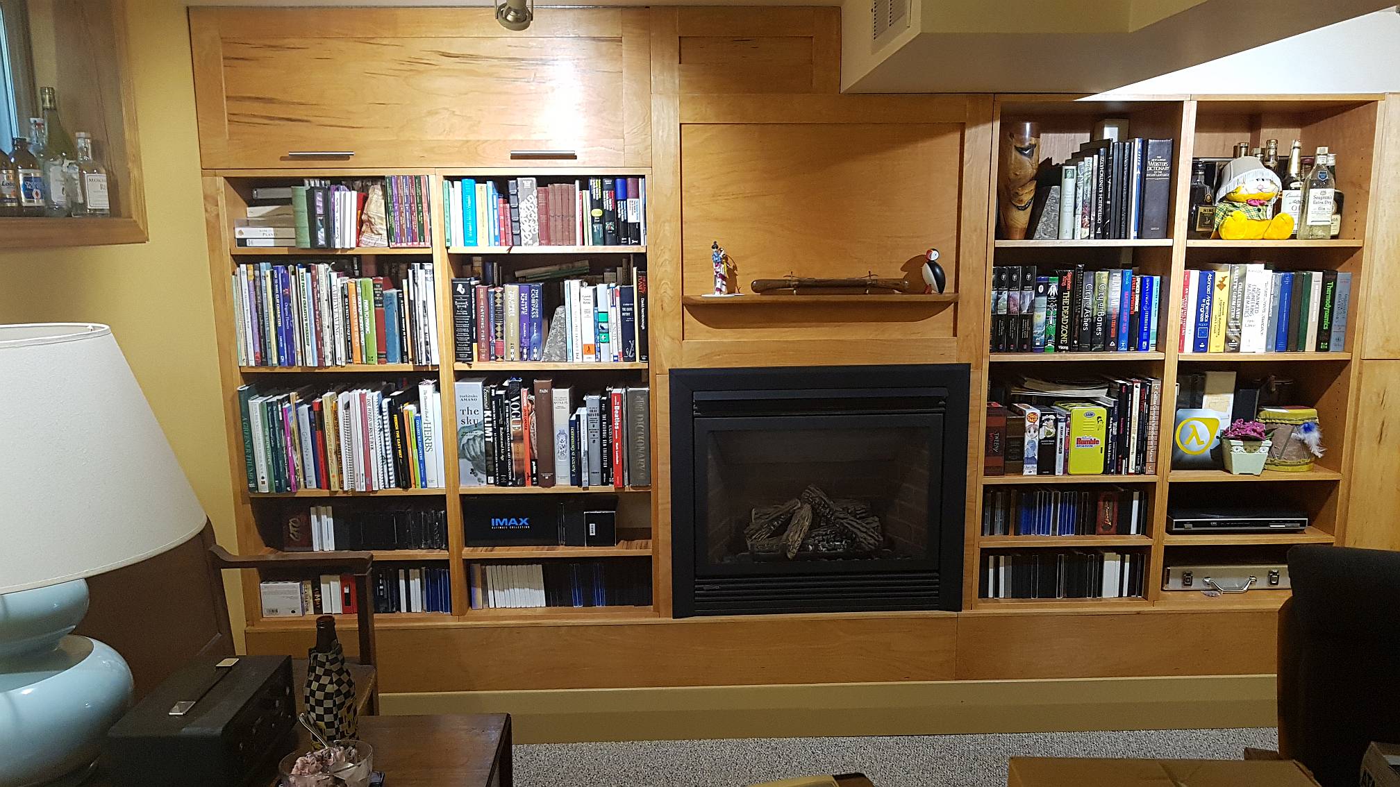

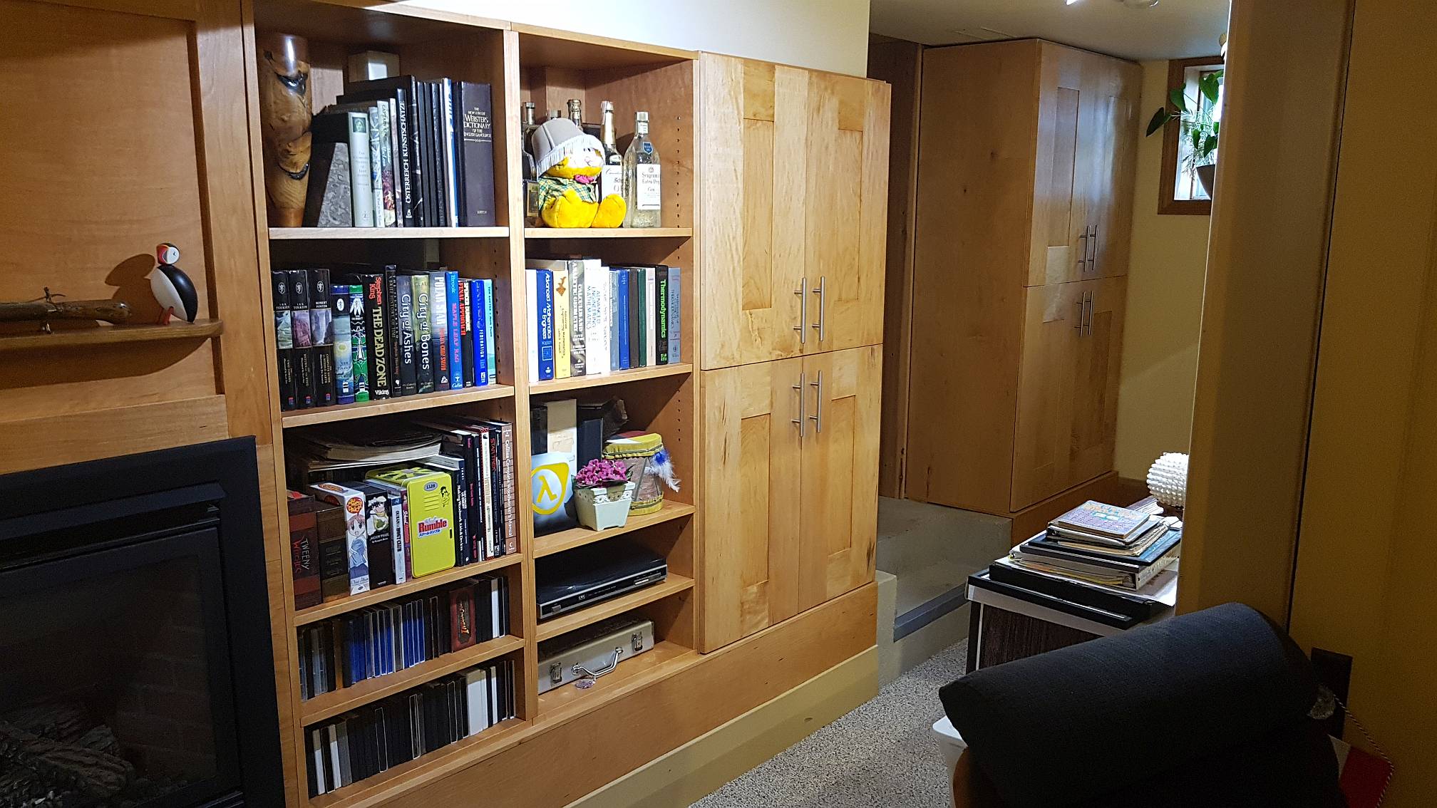

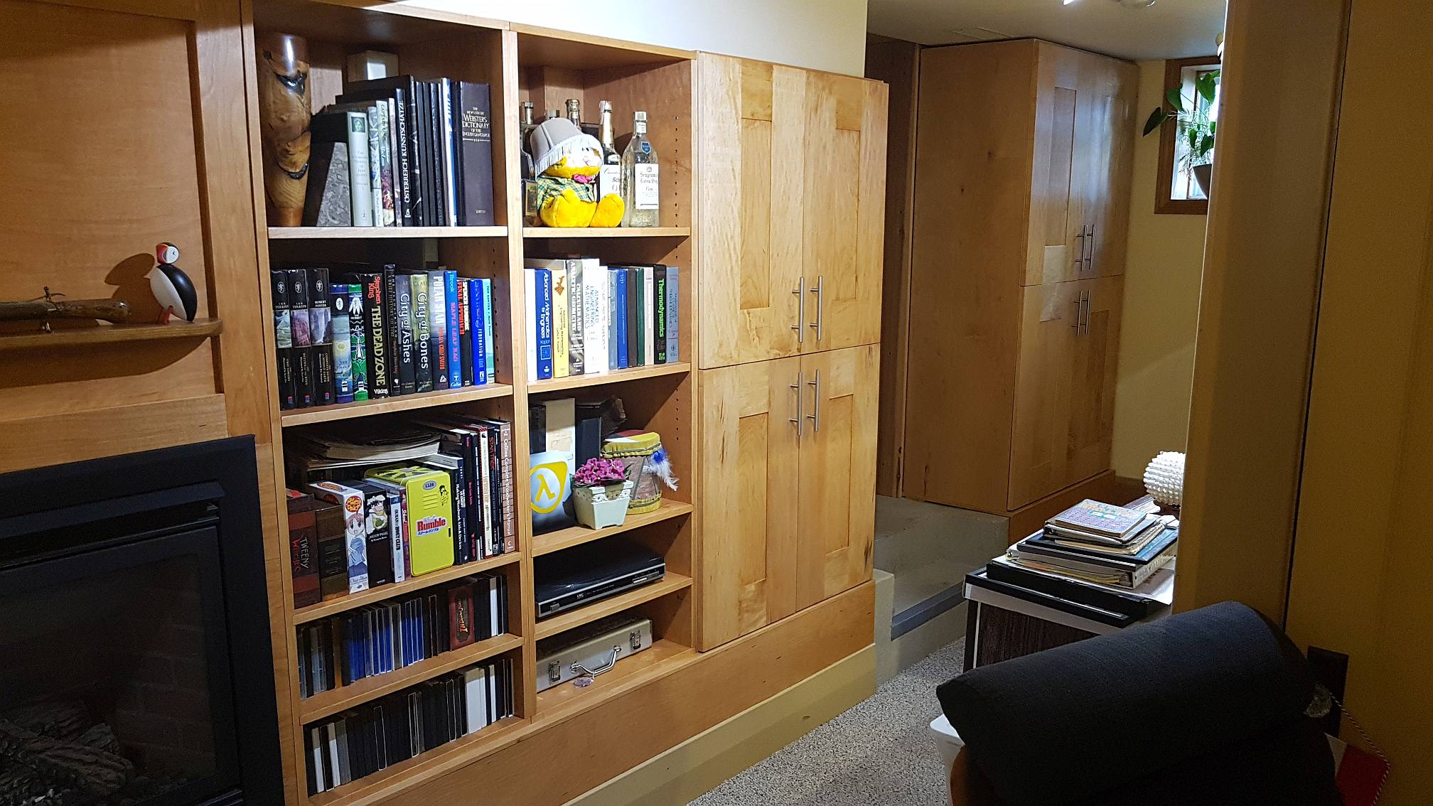

We like natural wood and wanted something light coloured that would not darken the room, so I chose to go with maple which is readily available in veneered plywood and solid boards. For the finish, I have wanted to try Danish Oil and chose the Watco fruitwood for it's nice warm colour. Maple is normally very pale but I wanted something to complement the wall colour.

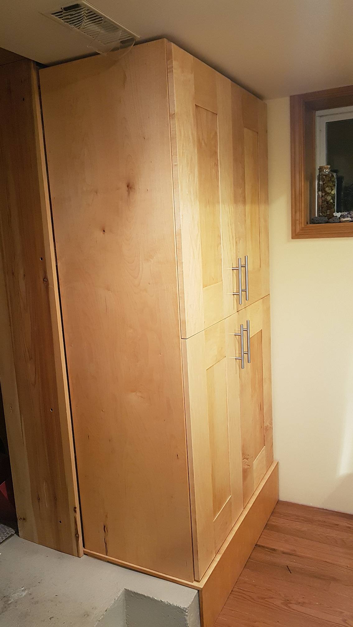

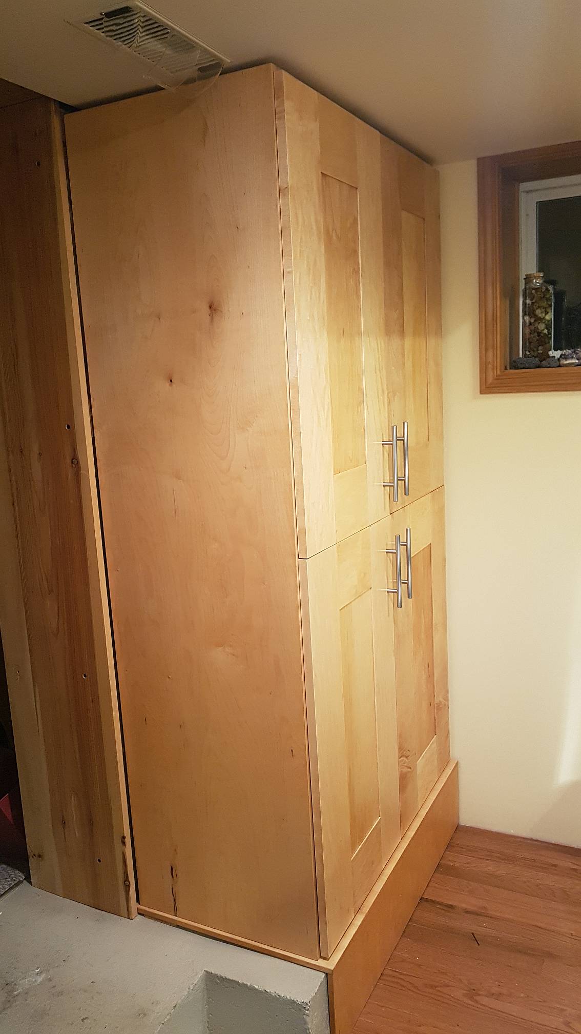

Clad the concrete in plywood to give me a clean level base and to have something to attach the baseboard to. It was pretty cramped in my small shop making cabinets that tall but I had just enough room. Finished the pantry to the right first and then installed cabinets from the left across. Today was a banner day because I got the last set of cupboard doors installed which makes it look much more complete. Still have 8 sets of drawers to build which will go in the 4 pairs of cavities at the bottom of the 4 book cases. The book cases are cramped right now as we're still deciding what to keep. Will get cleaned up when the drawers go in. My vinyl collection is in the upper cupboard and the CDs and movies will go in the drawers with full extension slides.

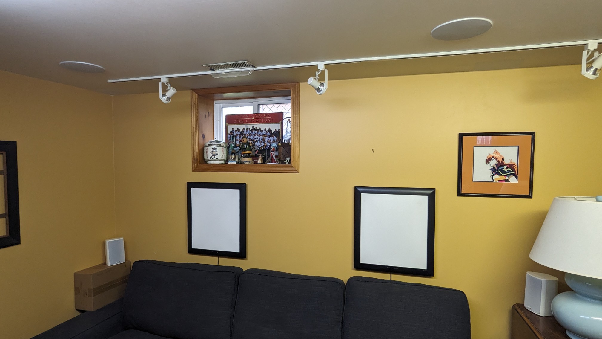

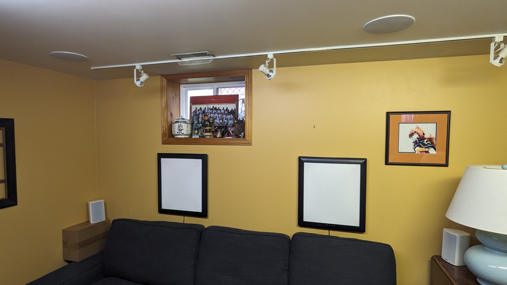

Building a system can be a journey, so I'll post the good and the bad. Moving to full surround from a pseudo surround setup was pretty cool. Watched Interceptor and a bunch of YouTube music videos. YouTube is only 5.1 but the Denon does well with Dolby Surround and Neural-X. It's still a novelty at this point but time will tell if surround music will have lasting appeal. Need to find some proper 7.1.2 music files or streams. Action films are definitely more immersive and TV viewing is more fun.
On the down side, the obvious issue is the aesthetic of the panel speakers. You can mount images without affecting the sound, but the location is not where one would normally hang art work. The wife definitely disproves. :D. Adding images and moving things around may help a little.
The other issue is sound quality. The panels have little bass. Audyssey crossed them at 250Hz which gives you an idea of how mid heavy they are. They don't get a lot of content so the jury is still out. The side surrounds turned out better than expected. They lack some bass as well but Audyssey did a decent job EQing them. Audyssey was not perfect though. I did 6 measurements and it boosted my centre and tops heavily at 125Hz and both are relatively flat speakers. Had to manual EQ to set things more to my liking.
I'll run it like this for a while, but I suspect that the rears will go. The Paradigm ceiling speakers sound great so the contrast is obvious. I'll probably end up with 5.2.2 but I may try front height speakers to fill the sound envelope.

FYI the Wharfedale LoudPanel was originally sold with a powered bass module (not a true subwoofer) as they don't produce much sound below 200Hz. You don't get any bass coupling from the wall as there is no bass. :D I added some black and white photos so they look better. The manual says you can use a low tack adhesive to add images and it's not supposed to degrade the sound. These can be found on EBay for not to much money.
There are companies that make in-wall flat panel speakers that you can plaster and paint over to create an invisible speaker. I've only known of one forum member who was looking into those but they perform like a bookshelf speaker.

I had a pretty good idea going in what the result might be. :) I'm only 9 ft from the mains so not much room to move the couch away from the wall but the side surrounds are slightly behind which is what they recommend if you don't have rear surrounds. This is more of an experiment. The lack of bass in the panels also tends to make music a bit bright with surround processing. I'm happy with the tops and glad that I spent the extra money for the Paradigm Pro speakers.
What do you think about removing the rears and going with front height? I think that's my last option. Either go down to 5.1.2 or try 5.1.4.
Found out that my old Klipsch sub is small enough to fit in behind the left main speaker stand. Can't afford a second SVS right now but the nice thing with the X4800H is that it has 4 independent sub outs which will help a little with having two different subs. Had some issues with the auto-on feature so I need to get it on the repair bench first.
