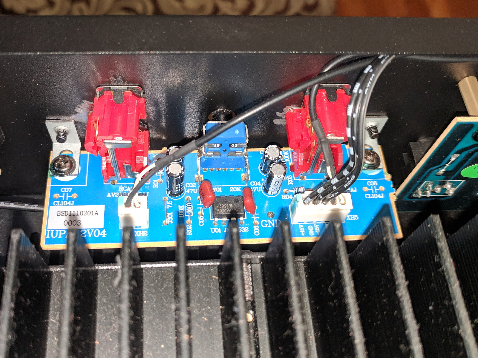

So,
I cracked it open and now I'm looking inside. I was hoping to see something obvious, but I don't

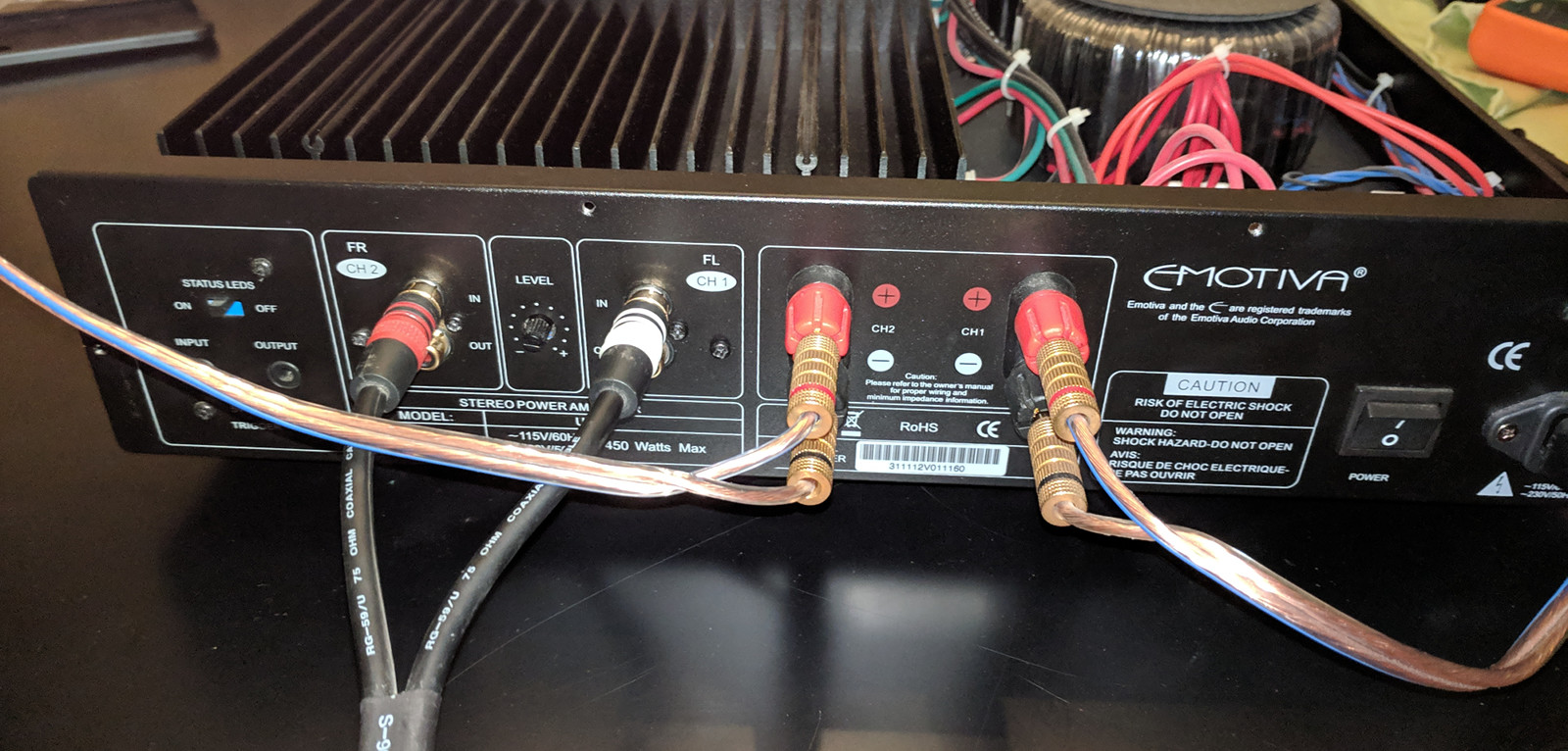

Some pictures (please excuse the dust, looks like I am going to have to blow it out before reassembling) You should be able to click on them for the full size.
Back of unit:
Input PCB attached:
Input PCB Removed, Top:
Input PCB Removed. Bottom:
I feel about 95% certain the issue is somehow with the input PCB. I guess it is time to crack out the multimeter and do some continuity testing.

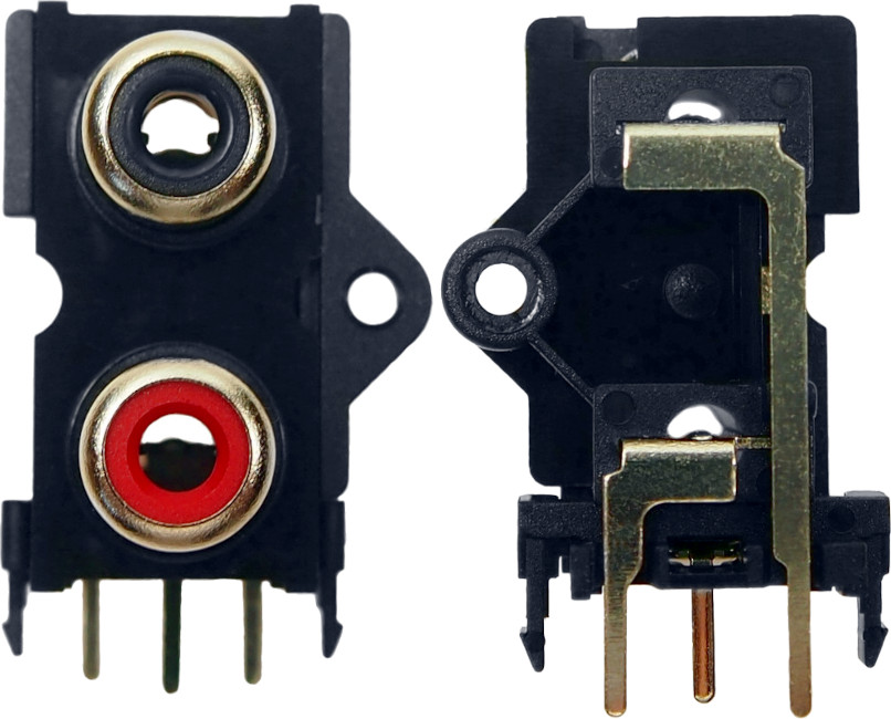

After some further research, it looks like what I might be dealing with is a custom all red version of a part with the part number FC684052.
It looks like the part I found is designed for stereo use, not for bridged use, but examining the Emotiva board, it appears it is electrically and physically the same, just different colors, and that the two connectors are bridged on the board...
Anyone have any thoughts?

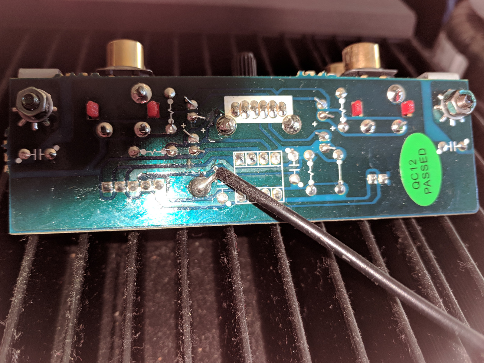

Both channels work if I remove the board and run it outside the case. (Side note, touching the wrong with with the case opened and powered on can kill you. Don't do this :p )
Then, when I assemble the board back into the case, the left channel stops working again:
At least this explains why my continuity tests worked...
mattlach
mattlach
My first thought was that maybe the solder joints at the base of the connector had cracked, and the pressure from being tightened to the case was pushing them in just the right way to break contact.
My next thought was maybe I should reflow those solder joints with my soldering iron in order to fix it.
Looking at the three joints that connect the RCA connector to the board though they look in perfect condition.
This makes me think that there is some sort of break inside that dual board mount RCA connector, bringing me back to thinking about that replacement connector I linked above.
Anyone have any thoughts or suggestions?

I don't see a break on the board. From what you say, I think that it is possible that the RCA input block has failed.
Put an RCA plug into the input socket and see if it makes contact with the first solder point on the board. If it does not you have your problem. If it does trace all the point to point contacts on the board with your ohm meter. I don't see a break in the board, but you have to be alert for dry solder joints. Test all the solder joints on that channel.
If it all checks out then half of the dual IC op amp chip has failed most likely.
Can you post the number off that chip and I will look it up.
That board looks pretty serviceable to me and trouble shooting should be pretty simple.

Greatly appreciate the offer. You are talking about th ecomponent labeled U01? That does look about the same size as I recall previous op-amps I ahve seen looking. (as mentioned, I'm a layman who (sortof) knows how to use a soldering iron and a multimeter, not an electrical engineer.) My discipline is Mechanical and Industrial engineering.
All that said, do you really think it is the OP amp?
The reason I ask is, if you refer back to my open box testing, in post #8 in this thread, the left channel magically starts working again, when I unmount the input board from the chassis.
This strongly suggests I am dealing with an issue of intermittent contact, not one of chip burnout, correct? And since the contacts look so good on the bottom, my thoughts immediately went to the internals of the RCA block.
My problem I have with any further continuity testing is that the damned thing works when I unscrew it from the chassis, and stops working again when I reassemble it to the chassis... So in order to confirm where the issue is, I need to do it while mounted, and I can't reach the bottom of the board with my multimeter when it is tightened down...

Is there an easy way to gain access to the bar? Looking at the pictures I took earlier, I can't quite see how I would access the portion that goes inside the connector to bend it, without breaking the whole thing open.

I think there is a good chance that you are correct about intermittent connection due to being tightened. Have you tried having the board back in place but not tightening it down? If it work just sitting there, then you can try tightening it gradually, see what happens, and go from there.
To me it is good news that it is just a connection/contact issue, it is a matter of time before you can find the point of trouble, by process of eliminations, metering, and applying pressure at different points to find the intermittent connection. I highly doubt the OPA is the issue, if it is, it won't work with the board outside consistently.
