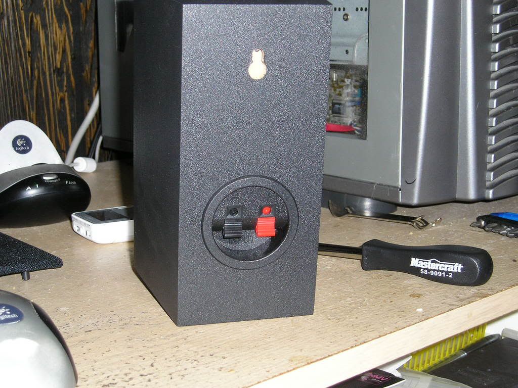

-Satellite speakers use real speaker wire that can be changed out for a longer run.

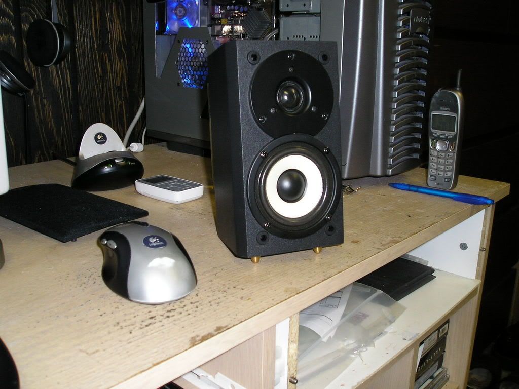

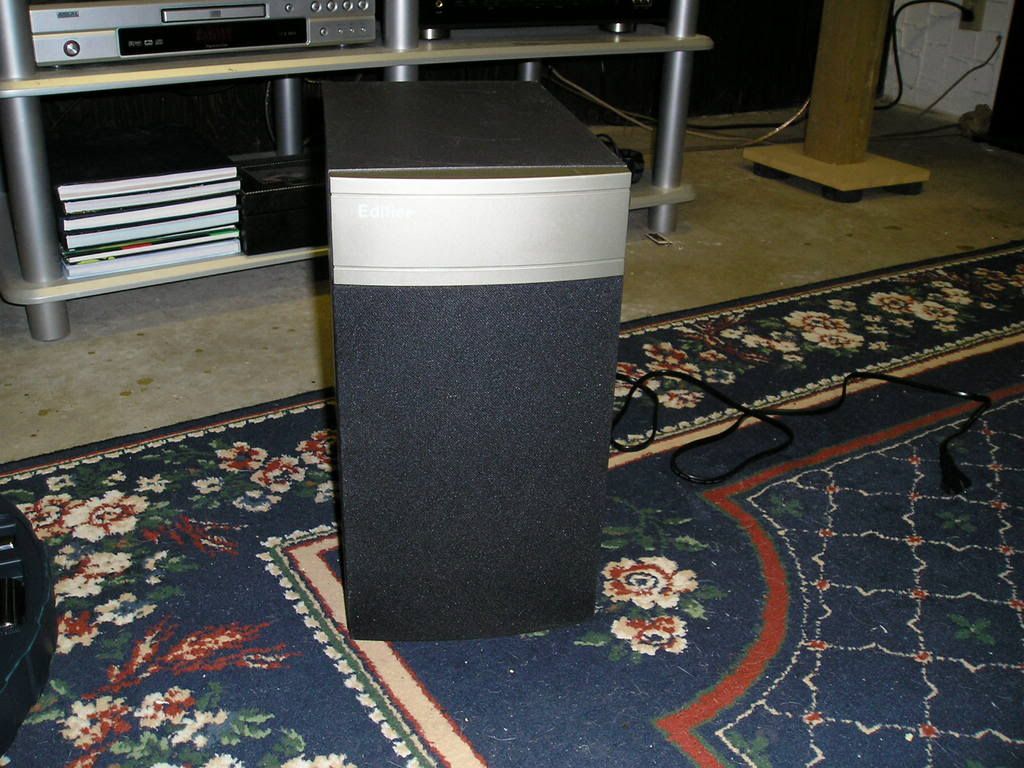

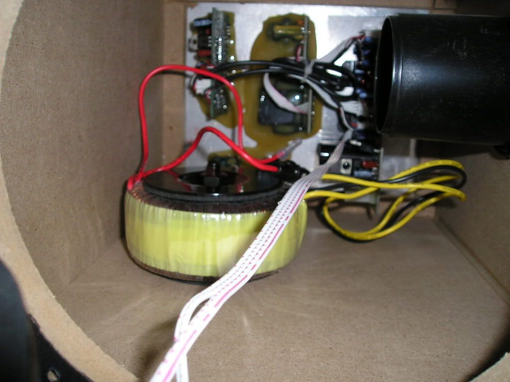

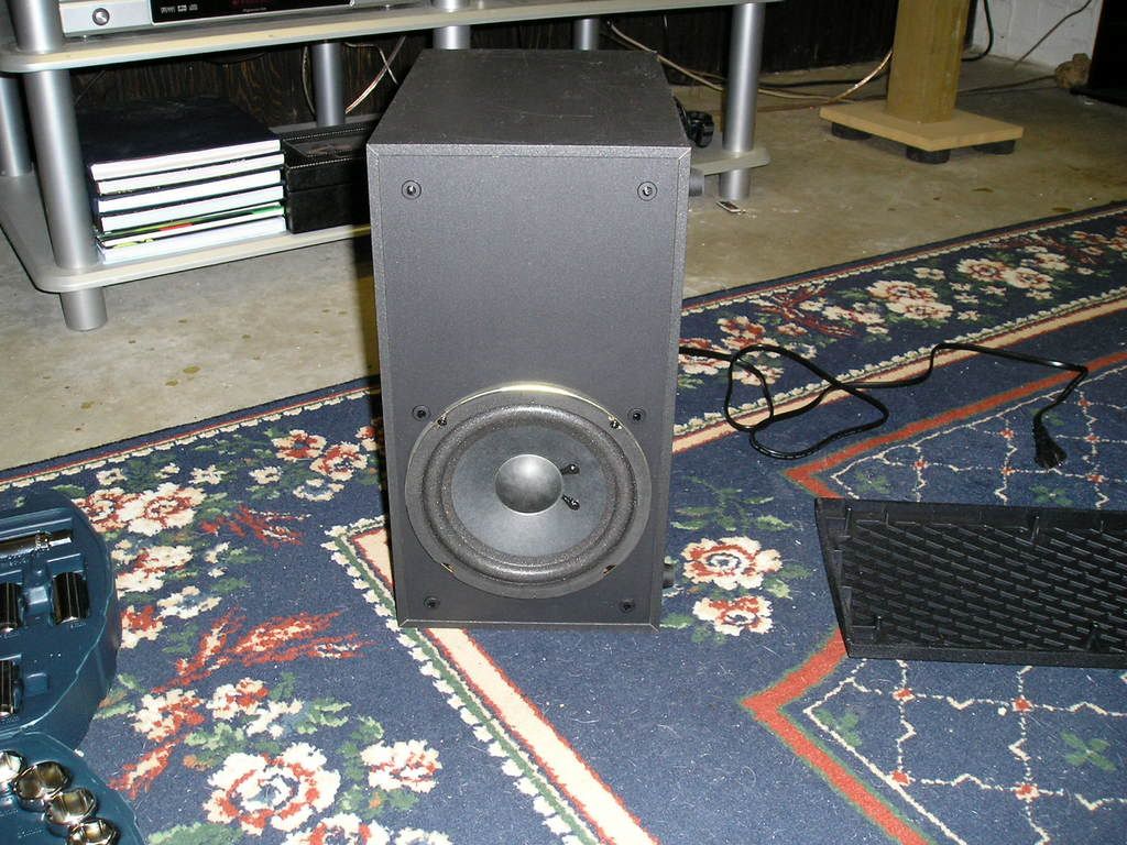

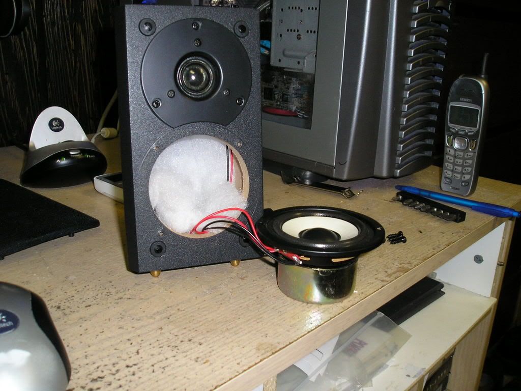

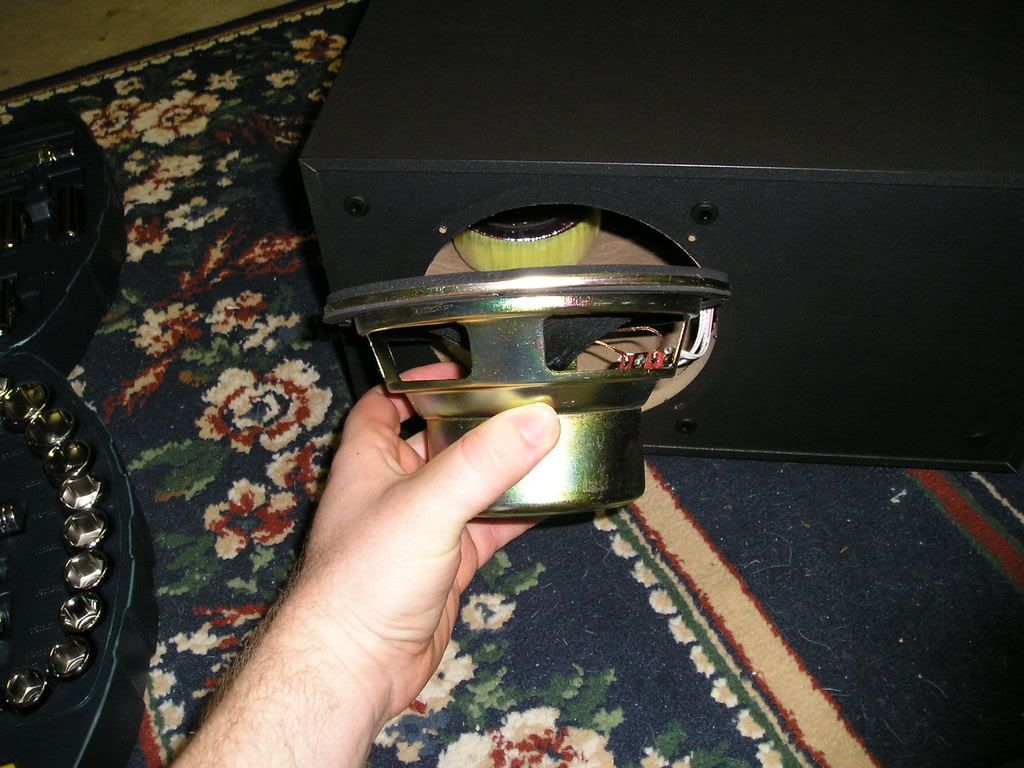

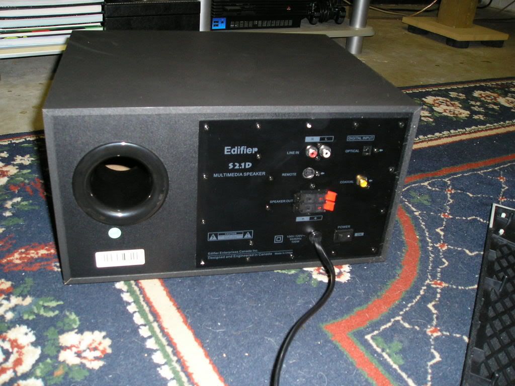

The speakers themselves are built very well. The satellites are MDF, and given their size, require no bracing. The subwoofer is also constructed out of MDF and has 2 chambers. One houses the driver and amp which then are ported to another chamber. This chamber finally ports to the listening room. One benefit of this design is the wall between the chambers acts as a brace. The satellites are sealed. One thing I would like to see changed is the non-flush mounted drivers. The grills use plaster frames and an acoustically transparent cloth to cover them with plastic push pins to hold it in place. Removing them isn’t easy, and I caution you before reefing on it as it could snap. Make sure you pull slowly and evenly.

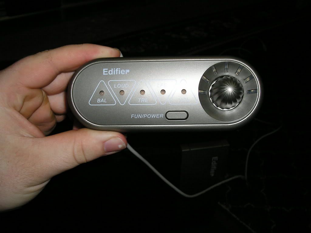

The Remote is nothing too fancy to look at, but functions well, and has many features that would not normally be included with a 2.1 system. There is adjustments for Balance, Loudness, Treble, Bass (Referred to as LFE), and of course volume. There are only two controls on the remote, the volume knob, which adjusts the level for every function, and a FUN/POWER button which scrolls through the functions and turns the unit on and off when held down. After you are done selecting a function, the remote will default back to the volume function.

When I first set these up, I went for the digital input (Coax). Analogue? Phhft, this is the 21st century. Well, the 21st century still has its kinks, and for some reason I was getting popping sounds from the speakers (could be the internal DAC). Switching to the Analogue cable fixed the problem.

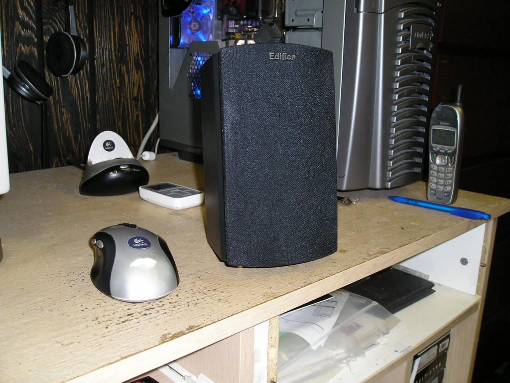

Each satellite speaker is placed on each side of the monitor, and toed in slightly. The subwoofer is lying down, in my foot area under my desk, with the port 6 inches from the back wall. The bass level is just under half, and the treble setting is half. Balance is at center, and the loudness off. Speaking of loudness, this appears to be quite a useless feature. When activated (only on/off) it boosts the subwoofer, and completely drowns out the treble. If that’s your sound, great, but I will leave it off for the review.

Using some of my favorite music tests, as well as my favorite music, I began my evaluation. One of the first things I noticed is the vocals. They’re directly centered between the speakers (and monitor). This many not seem THAT important for music, but when gaming, you want important sounds to be that clear. Selecting track 4 “10,000 days” of the Tool album 10,000 days, I saw just how serious these speakers were. The thunder that rings in the background sounded like it was all around me with impressive dynamics as well as low end. Now, the subwoofer isn’t a bottom digger, but it can muster up some impressive output in the mid bass range and really give you a tactile sensation.

After a week of so with these speakers (I work fast) I am very impressed. I’ve owned and previewed many computer speakers in the past, but none of them could muster the sound quality these have. What the subwoofer lacks in extension and output, it makes up for in control. Rock sounded great, and that’s mainly what I listen to. I recommend these speakers for a listen, especially considering their price.
