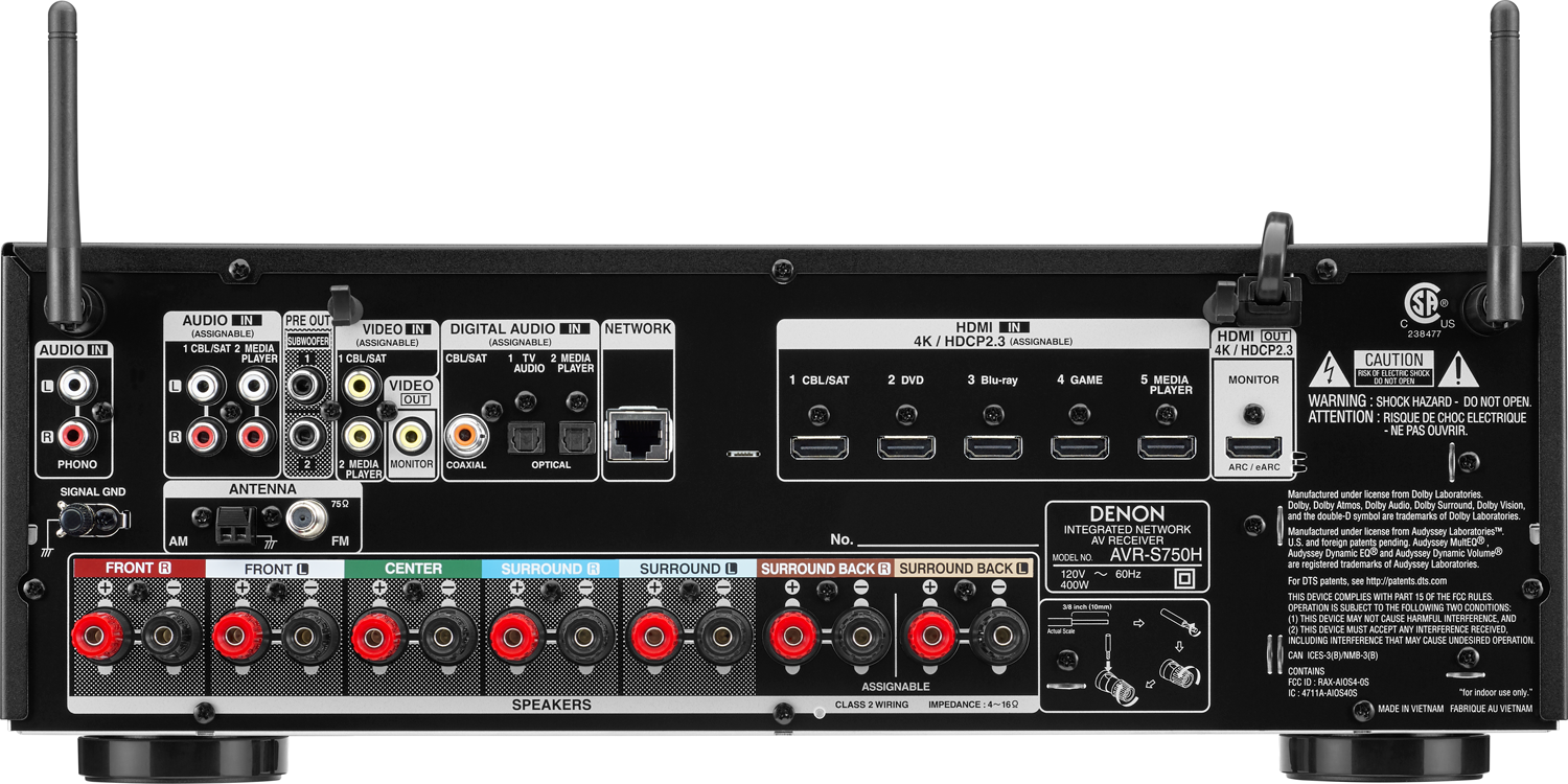

For anyone about to Google what the back of a Denon S750H receiver looks like...

Thanks so much your so correct about HDMI 2.1 none in homes yet. My TV is a TLC model is 55S401 so I guess the optical cables are a no go as the HDMI cable that I will plug into the eARC port covers the sound too all new to me sorry bud and many thanks for posting a pic of the back of my receiver...wow!
