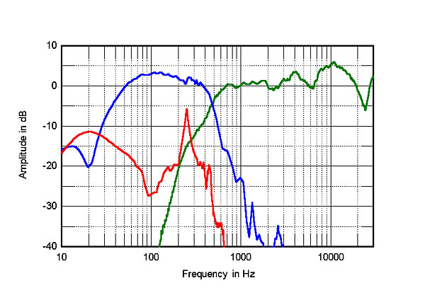

All I can say is that the Stereophile measurements would indicate that the speaker would have a degree of sibilance, and yet I detected not a trace of it. In addition the speaker would be expected to sound somewhat forward. The speaker infact sounds slightly recessed which is much more in line with the slight dip in response I measured at 5 KHz.
The slightly recessed sound is more due to the power response dip around 2kHz. The peak at 4kHz is the crossover frequency, so it's not a power response peak. It's only a peak on-axis. Similarly, the 5kHz dip is not present off-axis in the H plane due to the fst mid driver response roll-off off-axis.
And lastly, the peak at 10kHz looks far worse than it is - again due to the off-axis roll-off. The power response, which is the sum of all radiated energy, is quite flat above 3kHz, which explains why the speaker sounds balanced in a normal furnished listening room.
The on-axis peak at 10kHz is more pronounced with the B&W diamond dome than many others, but it's still due to a combination of dome geometry and relative size proportional to the wavelength. The latter is what causes 'beaming' and the former creates the roll-off above 15kHz. It's because at that high frequency the physical distance between the outer dome and the dome's centre, viewed from the front - on T axis, starts to approach 180 degrees. The way to negate it is to use a smaller or flatter dome, but listening 20-30 degrees off-axis also works.
And for those who are not familiar with the B&W crossover design, the dips either side of the peak at 4kHz are the result of b&w's 'mechanical' phase alignment. The use of 2nd order filters usually necessitates inversion of the tweeter polarity, but B&W decided to move the tweeter forward by a half wavelength - to maintain absolute polarity (they claim). The downside is an out-of-phase situation between the mid and tweeter - one octave below and half an octave above the crossover point. Personally I think they would have done better to invert the tweeter, but it does have the added benefit of eliminating the potential for diffraction effects.
