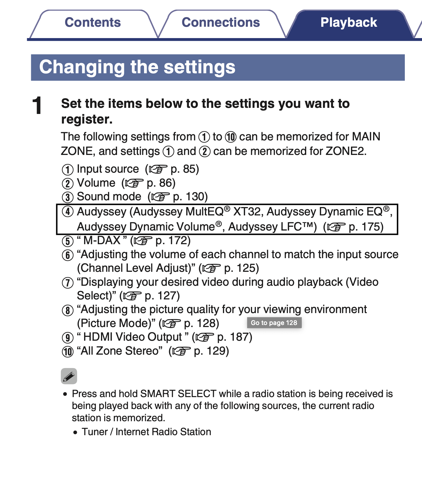

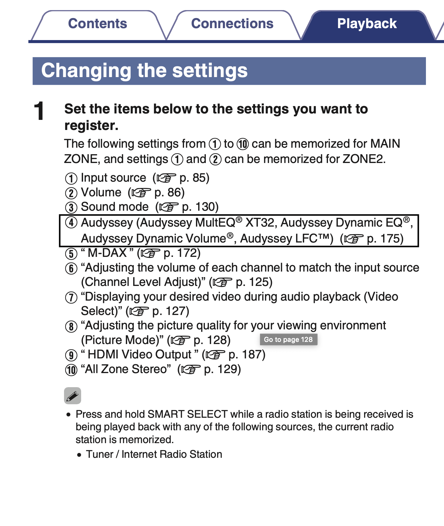

Most of the content I watch is streaming using a Roku as the input. Is there any way to set up different presets within the same input so that I could have dynamic volume on for certain types of content and off for others? And a similar question with respect to dynamic EQ. Can I set it for on and off and/or with different offsets, for example if I am using a Blu-ray player for both movies and music?
I was assuming I would have to make those adjustments manually before watching or listening to particular content.
The 4 smart select buttons might be able to do that, read up on it in the manual to see what they can do.
TechToys2
Seems like this might be a possibility. I guess these are the presets that lovinthehd was referring to.
I'll have to try it out. Thanks!
