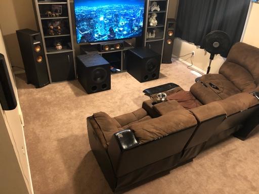

Dual PB-3000 or one PB-16 Ultra
B
Baaj
As Shady pointed out, If you end up getting a second PB-16 and have similar problems, for kicks and giggles, try running one of the two subs out of phase just to see if it makes any difference. I remember back in the ole car stereo days having to sometimes run a mid/midbass door located driver out of phase (manually or via the headunit).
Don't remember the technical jargon but I guess the two drivers were cancelling each other out when run in phase. You may be experiencing that in your room.
That makes sense because when I had the one pb-3000 it actually sounded pretty good with the chest thump. Two it felt like everything was gone literally. Also should I run my pb-16 ultra on extended mode or standard. I usually watch movies on Netflix primarily.
