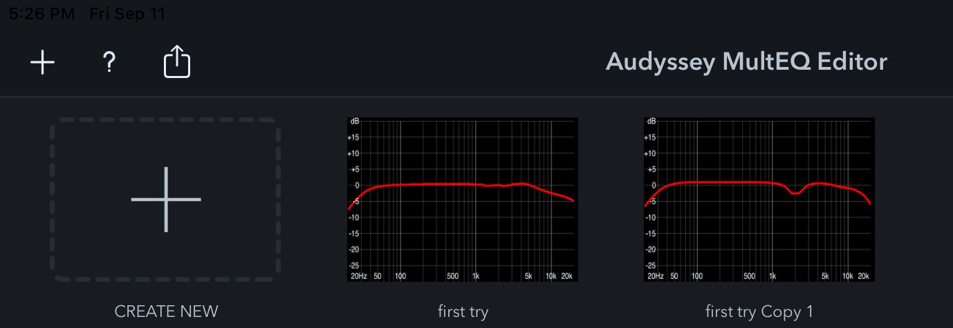

I just ran Audyssey with the app...uhh...sounds great. How do I interpret the data and adjust?D337F917-4229-4DE4-8736-BBEE52B50799.png7E6AF9CF-7F5D-4B1B-8DEE-365B5FE3203C.png990FEA82-C4F2-4C08-A640-8DC2BE1E11D0.png
Old Onkyo
Old Onkyo
Better yet, is there way way I can load the file here? I notice a drop on every graph at the 2k line. I am guessing I want to eliminate that dip?
ryanosaur
ryanosaur
Just TURN OFF Mid Range Compensation. It's one of the options in the Audyssey App. :)

Like Ryan said, that dip is what they're calling "midrange compensation" and you can turn that off for a flat response without having to draw it in.
Great tip Ryan. Worked like a charm.
