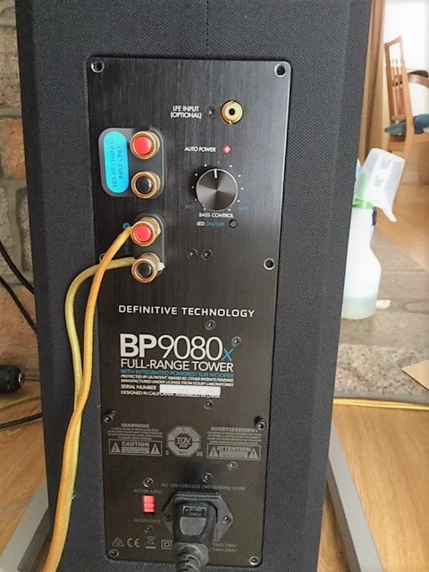

Does any one know how to disable the auto shut off feature on BP9080x, it is most annoying as it operates frequently at low levels of volume instead of operating at no audio. The result is a loud click / thump at regular intervals. Thanks in advance!

This is a straightforward audio system, the speakers simply connect to the amplifier output via speaker cable. The speakers have a standard input option which powers the various units inside including the bass unit (via an internal amplifier) there is also an input marked 'LFE' which is to do with Dolby in some way apparently and drives two additional units at the top. I am not clear what this is and there is little mention of it in the book. However all this won’t alter the threshold level at which the bass units amplifier powers up. The 'thump' when the amplifier powers on is not too bad but if you turn the sound down a bit then after ten minutes or so the amplifier powers off with a much louder click / thump which is alarming! DT have not replied with a fix - I have written several times to them.

The bass speaker only operates with its amplifier in circuit. The connection options are indicated on the rear panel (see pic). I have connected as shown. If I connect the main amplifier output to the alternative input (LFE) then the two units at the top of the enclosure operate but the others don’t including the bass unit. I am okay with the general performance of the speakers. I don’t know what to connect up the LFE input, but I don’t think any of this will fix the issue but could be interesting to check out if you know what to do. (I don’t!).
