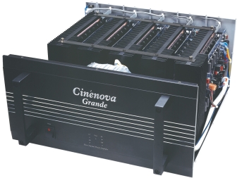

I am getting an EarthQuake Sound Cinenova 5 delivered today and I've been chit-chatting with their not so descriptive and not so helpful support team through email and they've told me NOT to connect the amp directly to either a line-interactive UPS OR a power conditioner... to just plug it directly into the wall. I'm assuming I could at least use a power strip.
He said it would be "Not good for the amp." regarding the Line-Interactive UPS and to "connect power to the wall", and for the power conditioner he said "MAKE SURE NOT TO CONNECT THE CINENOVA TO A POWER CONDITIONER."
So, my questions are... Does this seem right ? Are all amps like this ?

I assume your talking about this pictured below? I have no experience with the Earthquake, but I have heard of the name over the past 7 years.

Well, I can not imagine the reasoning for such a warning.
A good UPS simply creates a clean sine wave of the desired voltage in absence of normal line voltage.
However, your amplifier, from the picture, appears to be substantial. You might (?) need a commercial grade 2000VA large capacity UPS to drive that unit off of battery power.

This is only true if you choose a crappy power conditioner that uses a variac to regulate the voltage. Believe it or not some of the BIG brand power conditioners still do this. If you choose a reputable conditioner from the likes of APC for example, this will NEVER be an issue.
Check out the article I wrote which discusses this:

As gene said, if you choose a reputable one, it should not be an issue. The real issue is, this monster amp apparently has a 4 kVA transformer and can output a maximum of 300WX5 into 8 ohms or 600X5 into 4 ohms. Assuming the amp is 50% efficient, to output 1500W it has to take in 3000W, or close to 4000VA. So your 2200 VA, or 1600W UPS is not going to cut it. It will work (very rarely would an amp be required to deliver their maximum rated output to all 5 channels), but you may not benefit from the amp's full potential, depending on the kind of music/movies you play with it. This is only from the VA/W stand point. If that UPS has some sort of filtering device and/or current limiting device in series, it may or may not have adverse effects on your amp.
By the way, does the amp allow you to use two 20A circuits? If not, I hope they come with a 30A power cord so that you can run a separate 30A circuit for it.
