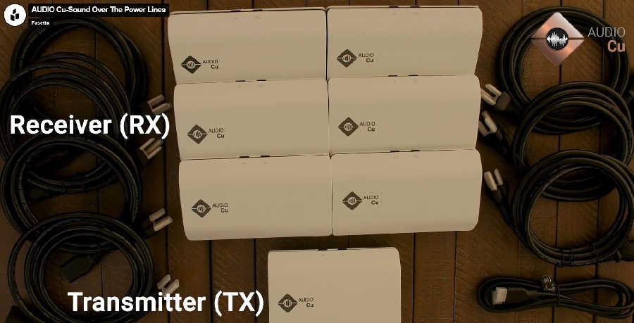

AUDIO Cu is trying to revolutionized home theater audio by using power line technology to deliver high-resolution Dolby Atmos sound, eliminating the need for complicated wiring setups or even AVR's!
AUDIO Cu’s technology completely replaces the traditional audio-video receiver (AVR) and speaker cables to provide "a seamless solution for distributing sound to speakers and subwoofers throughout the home." The system can support up to 10 different audio channels per setup, allowing for configurations ranging from basic 2.0 stereo systems to immersive 9.1 surround sound, including Dolby Atmos setups as advanced as 7.1.2.

I don’t see this being a big problem. The pictures show attaching the unit to a speaker, jumping speaker wire to the binding posts, then plugging the unit into the wall. Seems to me you could just as easily mount the unit near any convenient electrical outlet, then run speaker cable to the speaker from there. Sure, you’d have some speaker cable on the floor, but we’ve been dealing with that forever. :)
The big problem I see is Atmos speakers. No quick-and-easy for that. I hope the gizmo can live in an attic, because that’s where it’s going to have to be, if there's no convenient closet to install it where you could send speaker wires through the ceiling into the attic. But then, closets typically don't have electrical outlets...

The AUDIO CU transmitter module has an eARC port. So, it must be connected to a TV with an eARC port to receive an Atmos/Dolby TrueHD bitstream. DTS is not supported here. A single system will be limited to, 5.1.4 or 7.1.2 or 9.1 channels and a wifi network and Smart device are also necessary to have in the home to use it. It is a very pricey and very limited affair and frankly isn't worth the cost of entry simply to avoid running conventional speaker wire.
