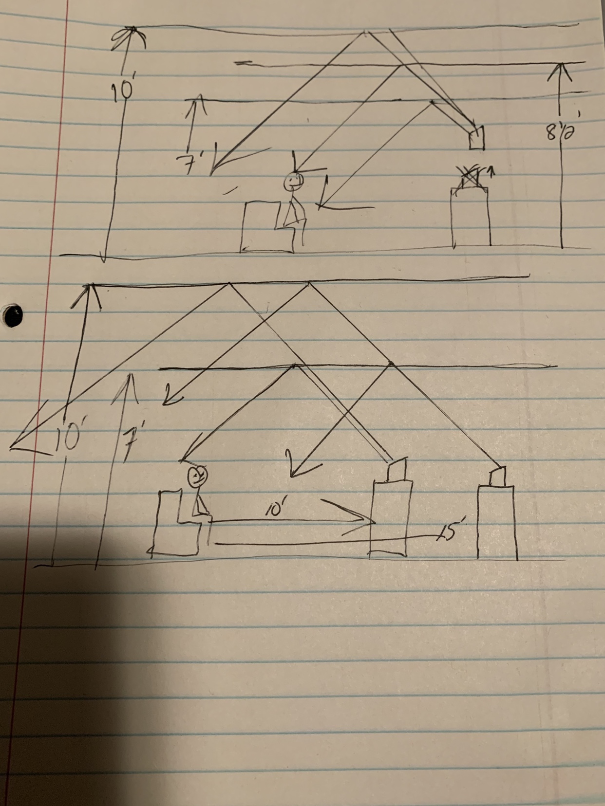

I would try and mount them in front for a 5.1.2 system. Even still, you’ll need to try different heights above the mains or different angles to make they’re bouncing off the ceiling at a correct angle. Think bank shots in pool. Definitely do not mount behind the surrounds. That location might be closer to you but that’s not the point. Atmos works by phantom imaging between ceiling speakers and bed layer speakers. In upfiring applications, there is a frequency response notch to help the with the illusion that sound is coming from above you. This makes it much more difficult to place, and as such people have as you said, had poor results. If you can’t go on/in the ceiling my second choice would be, as mentioned, something like SVS’s prime elevation speakers or something like that mounted about 30°in front of you. If you have to do the bounce house, take great care to find a good angle that will hit the LP.

I can’t remember what angle AE speakers fire at, but this cartoon image might help illustrate what I was trying to say.
It just kinda shows what might happen by tailor lowering them. You could probably do the same thing by simply tipping them forward or backwards slightly.
You have no idea how greatly I appreciate you taking the time to even draw that out! I’ve purchased the Klipsch RP 140SA’s that can act as surround as well as being Dolby Atmos Enabled or upfiring. From what I’ve seen many have had success mounting up high rather than trying to bounce. I feel it would be practically impossible for me to find the exact angle and height to achieve that. Lol Not really time I want to spend doing that.. so since acting as surround/Dolby Atmos Enabled that most people have preferred wall mounted over atop speakers I wouldn’t need to angle them towards the ceiling (backwards basically) as the others just mounted them straight forward up high and were much more satisfied with them. Am just struggling with where exactly to place them. So for high wall mounted speakers between side walls, back wall behind surrounds, or front wall above standings you’d recommend above the front first for best overall immersiveness with Atmos aside from ceiling mounted of course? I believe this is what Dolby has recommended also.

I do have to admit, I made that cave drawing awhile back for another thread bought thought it would work here too. Lol
Well I definitely understand not wanting to try and find the best angle from the front wall. That would be a lot of trial and error. I actually think high and on the sides would be better anyway. Much more like a real in ceiling installation. Probably like 2-3’ in front of your LP(listening position). Definitely not anywhere behind you.
This is kinda what you’d be trying to do.

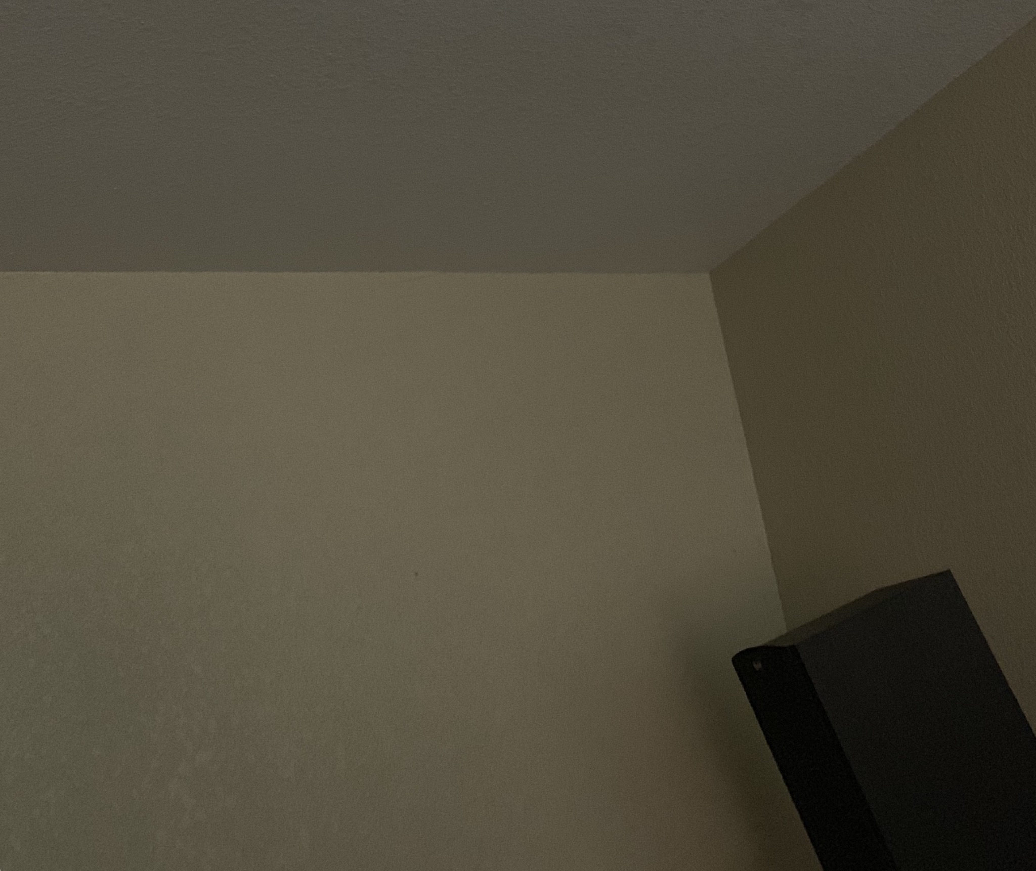

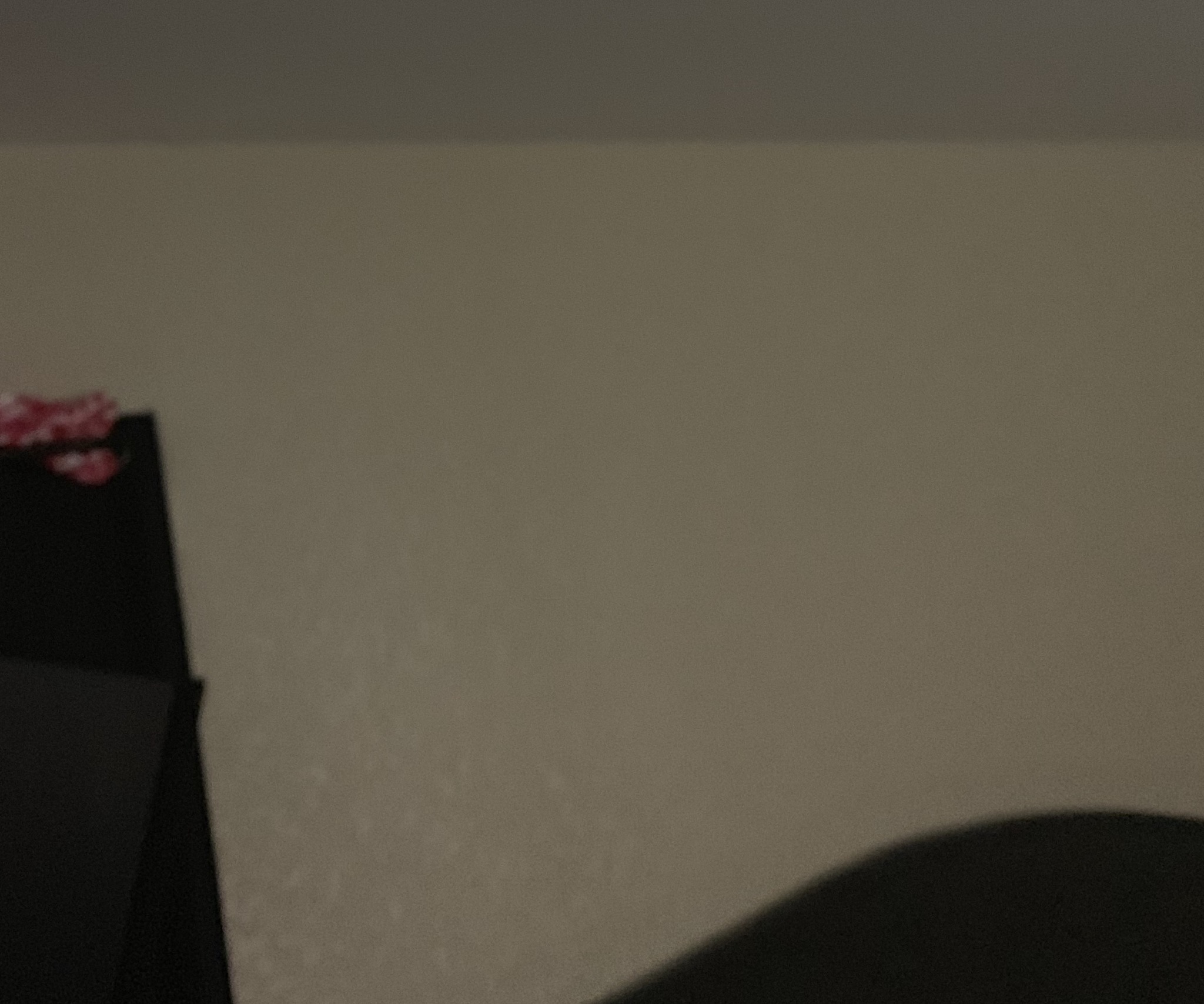

Could you shoot a pic towards the back of the room? It’s a little hard to see the installation and scale of the surrounds.
Whenever I tried taking a photo of the back of the room as a whole so you could see both surrounds together it says the image is too large.
