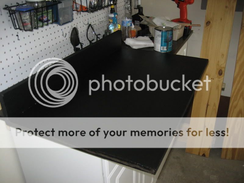

The good news, is it now has the spine. The bad news, the finishing nails and drywall screws were too short. I had some 2" cabinet screws and used them. They split the spine in a couple of places but I think it is fine, the glue has most of the holding power...correct?
I kind of forgot that the screws were just to hold everything in place as the glue dries and I went overboard with the screws. I used 8 screws...
That's why I mentioned pre-drilling in an earlier post.:)
Not overboard at all; 8 screws sounds about right

I pre-drilled the main shelf but forgot to pre-drill the spine. Plus I was a little off of center...:D
So this just acts like a rigid spine and should stop some flex or are you going to tell be I have to bolt the spine to the back of the credenza...which doesn't have a back.

No, that should do it, and don't forget to move the foam to the ends closest to the shelf support pins. The shelf is strongest at the sides and along the spline.
So you want to distribute the weight there, by moving the foam.

Nice job PD. I think you have more screws in the spine then I have in my panel mount :eek:
I think you should be fine with that support rail and it is hardly visible with that dark color scheme.
