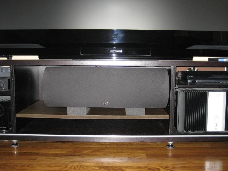

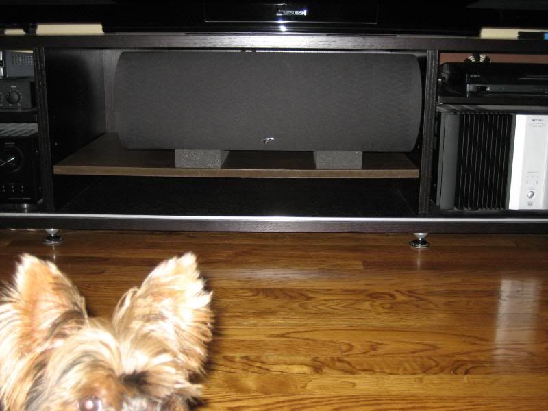

ParadigmDawg
ParadigmDawg
It is just held my 4 pins at the edges. There is no back or front of the cabinet unless you count the 1/8" masonite that hides the wires but I can't screw a brace into that.
Here's some pictures. Don't judge the paint job, I'm not done with it yet and the first shot didn't turn out as dark as I wanted.
I would like to use oak or something but I don't understand how to do the edge that Sawz referred to.
The dog always walks in front of the camera.
j_garcia
j_garcia
You need a 1-2" strip of scrap or whatever that is the same width as the shelf. You can screw through the top or bottom of the shelf into the edge of that strip so it supports the shelf, and that would be at the back side so you don't really see it from the front.
ParadigmDawg
ParadigmDawg
I don't quite get what you are saying. Just add a strip of the same stuff to the back length of the shelf? That doesn't change the 4 pins for support. Does it just strengthen the shelf?

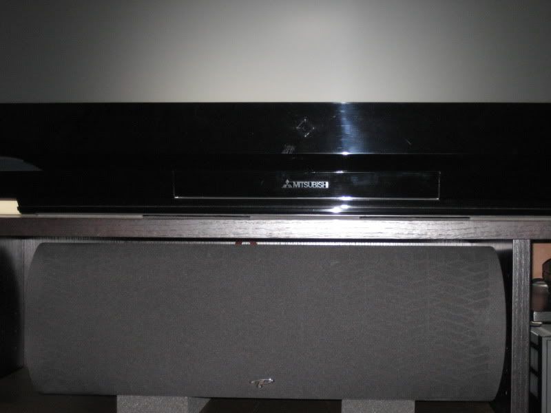

ParadigmDawg
ParadigmDawg
Oh...and here is one more pic for Sawz....
I wish it was more gross but I have perfect feet.
