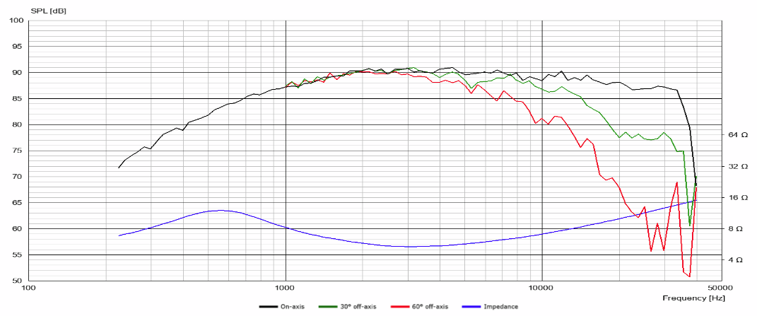

BTW, here is what REW shows I get with a Dirac Live generated filter and with loudness enabled for some additional salt and pepper at a modest listening level. At least Dirac has eliminated the forced character I was previously hearing in the mid/highs with Audyssey MultiEQ. Maybe giving an idea for my sound preference for rising slope to compensate for my aging hearing.
You should adjust the dB scale between 45 and 100, in 5 dB increments. You get much better resolution. That big scale has a way of hiding things.
Thanks for the feedback. Here it is with more detail. There are a couple room nulls below 100 that there is nothing to be done about within my speaker and listening location limits. The rising slope from mid to high is what I targeted.
