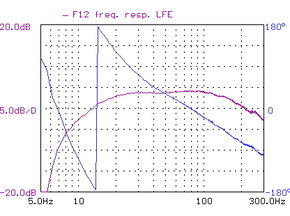

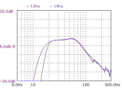

No, the servo system basically limits the bandwidth to 100Hz and down.
No, the servo doesn't; the AMP just has a built in LPF at 80hz because it's marketted towards """"purists""" who don't use receivers or processors.
If you get the versions with the A370PEQ amp it can be used with LPF defeated:
200hz as a -3db point is very acceptable. No one is going to run a crossover point higher than 120hz anyways, unless they want to lose localization cues.
