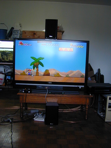

Like jostenmeat and others I also recommend an identical vertical center whenever I see the question come up. Horizontal centers sound so bad IMO I recommend matching bookshelf speakers up front if one cant fit or doesn‘t want towers.
I did too until I figured out I could do this.
Your right about getting it at ear height but since that picture was taken I put the mains on cinderblocks which put their tweeters within a few inches of the center’s tweeters. For movies this setup creates a sort of wall of sound effect (very movie-theater-like) while the pans across the front all stay in the same vertical plane. For 5.1 music the only difference I notice is that on some recordings it sounds like your are near the front row of a concert and looking up a little at the stage. Still seems very natural though.
Is this really what you have set up? With all due respect, that is wacked. Is this your main room, or in the basement?
I think this is a great example of what makes sense versus what is truly the best setup. I'll admit that this probably sounds the best, but how many people would realistically want a tower speaker on top of their TV (physically or aestetically)?

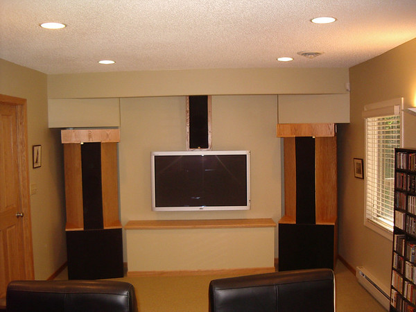

I'm not conviced that having the center above the screen is best, unless you also have one below the screen, which I've already tried. But I didn't keep both, going back to just the one below. A 24" tall speaker above just looked too out of place.
Although I have seen pics of in-wall LCRs that have the center above, I have to admit, that an inwall looks better above the screen than a freestanding vertical tower.
Yup that’s my setup. And I agree that it looks absurd. Yes it is my main room as I live in a one bedroom apartment. Here’s some more of what it looks like
As they say, don't knock it till you try it... and especially if the lights are turned off, and you can't see it.
I remember it was supervij I believe, who recounted a story. He put a vertical bookshelf on top of display I believe, and thought it looked really stupid. He did mention it performed in a superior manner. He had guests over, expecting the worst, and nobody said a single thing, but they all did they think it sounded great. I have no idea if he left it that way.
I believe that most people are conditioned to horiz MTMs because that's simply what all the photos, big box stores, and furniture magazines always have. We are sheep.

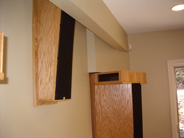

If you don't like the totally wacked look and already have your mancard platinum, how about the 'just a little wacked' look?

I don't think aesthetics can not be ignored in this problem. The easy solution of using the same drivers as in the mains in horizontal MTM, has exactly the wrong polar response.

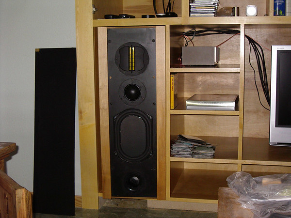

I designed my center channel speaker to solve a good deal of these problems.
I chose to use a coaxial driver for the center. The mid bass cone acts as a waveguide, to give coverage of just the listening area, with minimal interference pattern affecting the mains. There is time alignment, but some violence to phase in the speech discrimination band from the crossover. However speech clarity and naturalness has been excellent, and the sound stage moves in a seem less fashion, with no change in the character of sounds moving across the sound stage. This speaker is also an excellent music reproducer.
I believe the best options for the center channel are coaxial speakers, good full range drivers, or speakers with no crossover in the speech discrimination band, and also having a suitable polar response.
Coaxial and full range drivers have the best chance of solving the aesthetic problems. However even a vertical speaker angled to the listening position, does not have to look out pf place.
