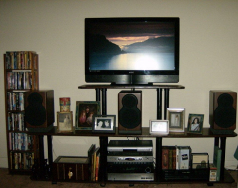

Or, sacrifice perfect "video height" and build your own cabinet...(I couldn't wall mount BTW)
Hey, it's a budget system in a small room. But I revel in the sound, starting with the basic premise of matching fronts, all on the same plane...And, yes, there is a noticeable difference vs. a horizontal "matching" center...:D

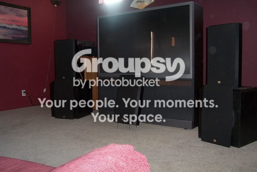

A vertical floorstanding center is a nightmare for those of us with rear projection setups. Honestly, it will be difficult to properly configure even an in/on-wall configuration at ear height with a DLP. Trading off-axis listening for off-axis viewing is something most home theater enthusiasts would care about.

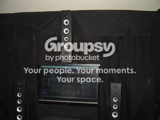

I did too until I figured out I could do this.
Your right about getting it at ear height but since that picture was taken I put the mains on cinderblocks which put their tweeters within a few inches of the center’s tweeters. For movies this setup creates a sort of wall of sound effect (very movie-theater-like) while the pans across the front all stay in the same vertical plane. For 5.1 music the only difference I notice is that on some recordings it sounds like your are near the front row of a concert and looking up a little at the stage. Still seems very natural though.

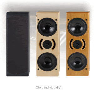

One thing you can try is to have identical vertical centers, one top, one below. I tried it and it will lock the voice to the center of the screen. I just didn't like the look of a 2 ft tall center above the screen. Even laying down was too tall (15")

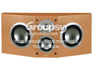

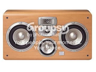

A bad center..........................................................coax LCR
Good centers
