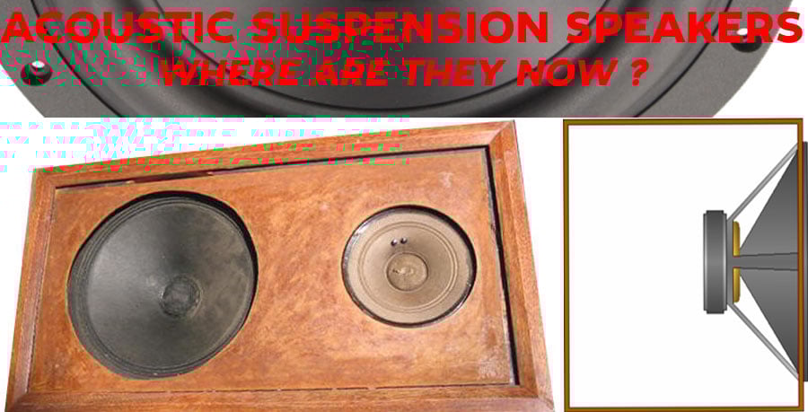

Do You Miss Acoustic Suspension Speakers?
