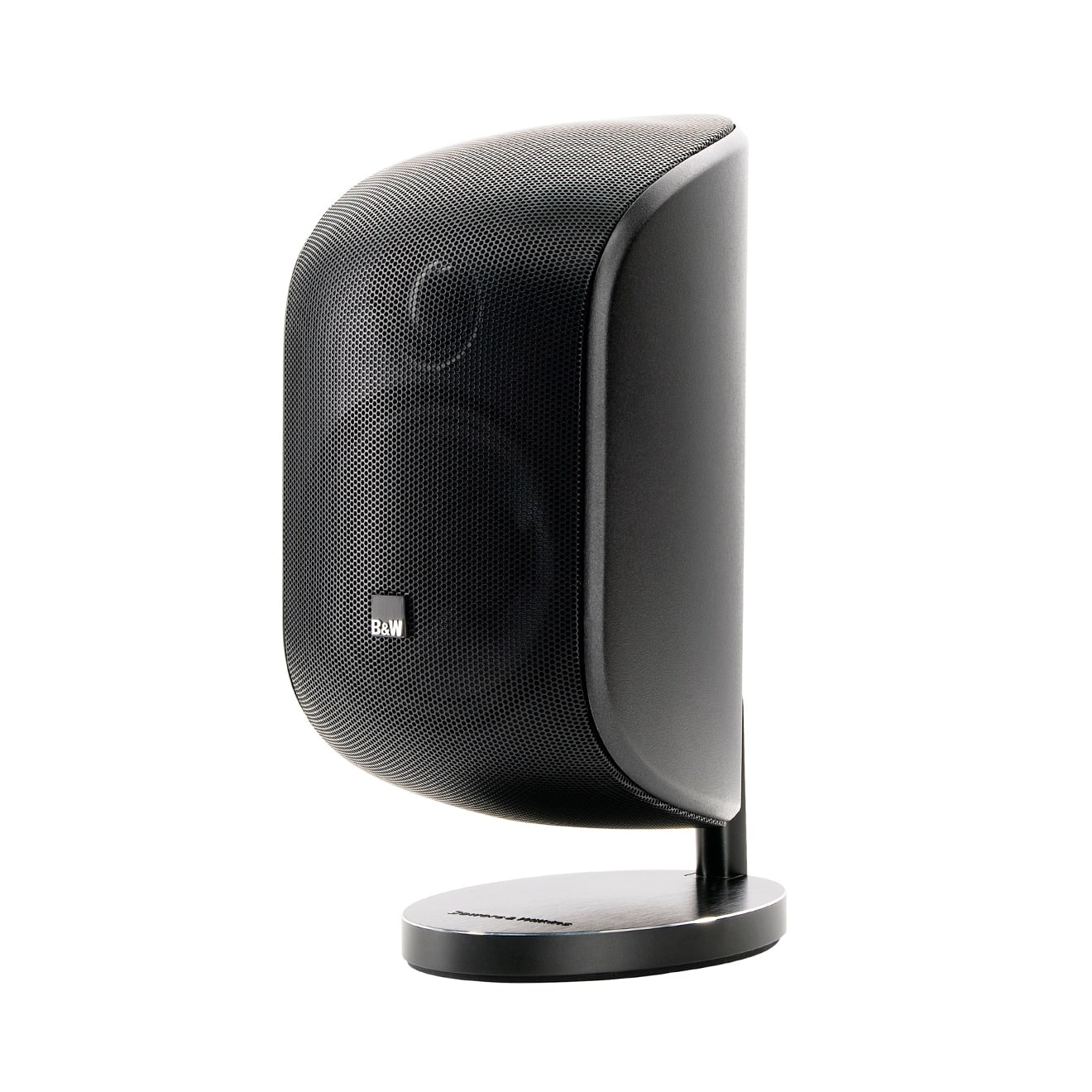

-L/R and Back Surrounds are B&W M1 (so these 4 weren't my first choice (S.O.), but so far so good) - Sensitivity: 85dB spl (2.83V, 1m); recommended amplifier power: 20W-100W at 8Ω.

Those B&Ws that are your front stage in that room are gonna be lacking. Forget amplifiers as they will make very little difference. Come up with a budget for the front three and sub and a plan to get them.

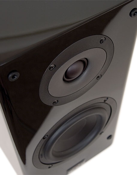

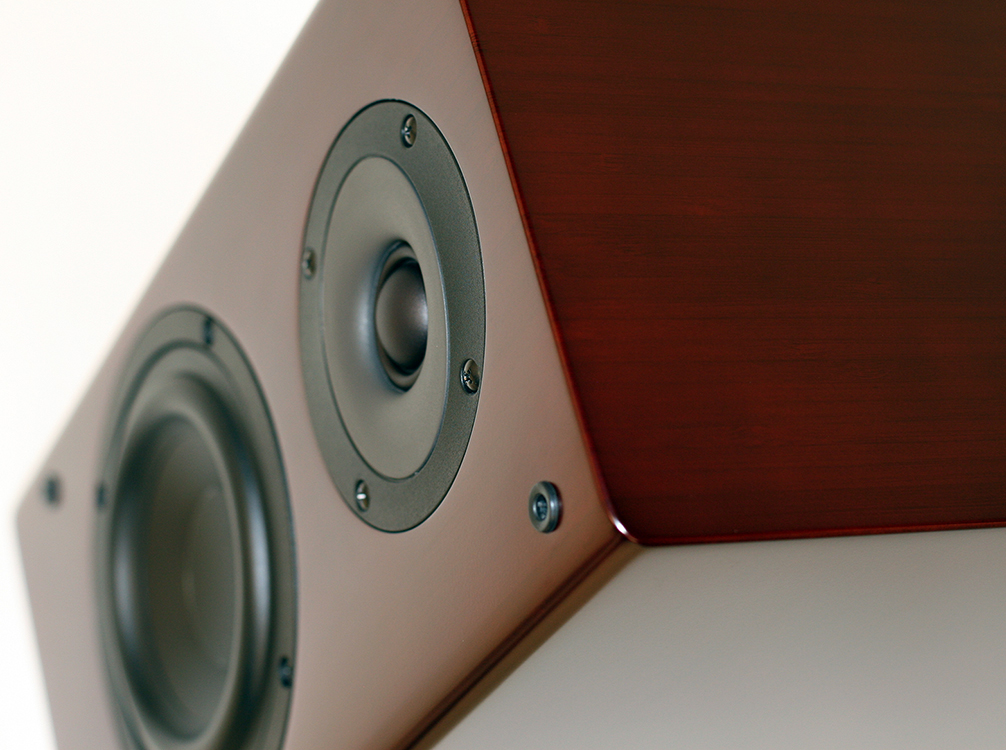

Your not Stuck. There is always a Solution.
How about a Good Looking set of Bookshelf Speakers with a Wood Finish or a Piano Gloss Finish?
