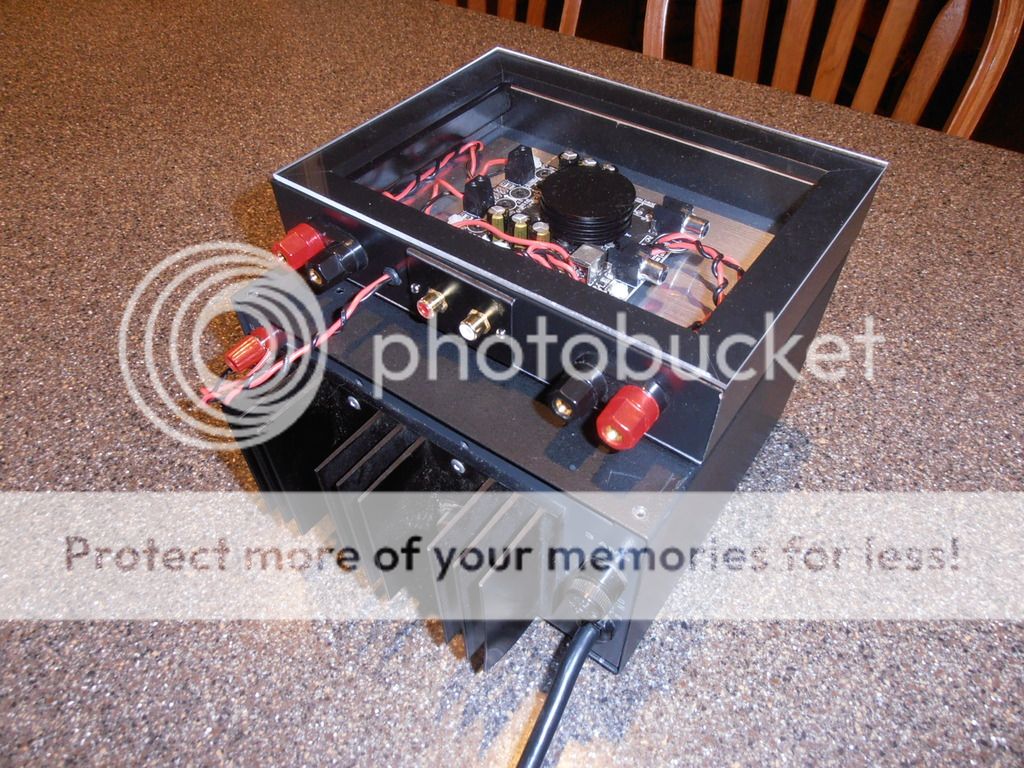

It's not a tube amp but this dual chip TPA3116 has a warm tube like sound. SQ is amazing and for the ebay price of $10.99 plus a $22 Pyramid regulated from Walmart online.
Massive threads abound ( diyaudio, AC and AK ) on this new chip from T.I. Not to be confused with your daddy's t-amp.

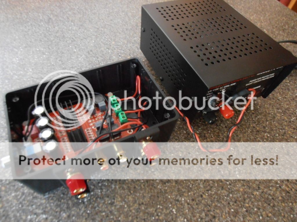

The TPA 3116 is not a tripath and it's superior to any t-amp I've heard and I own most examples. If you search TPA3116 100X2 on ebay you'll see plenty of dual chip amps. They're all the same so get the cheaper one.
A regulated PSU is a big improvement over the SMPS lap top bricks you see with these small board amps. Here's a linear Astron I'm using with this TPA3116 but it cost six or seven times the price of the Pyramid.
