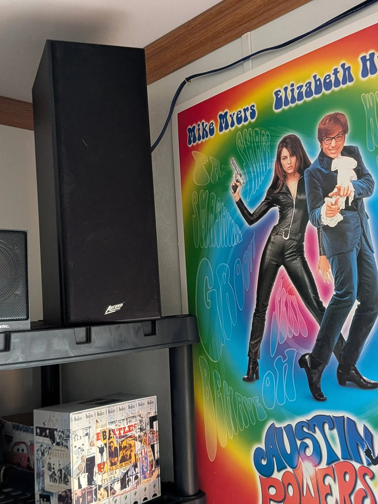

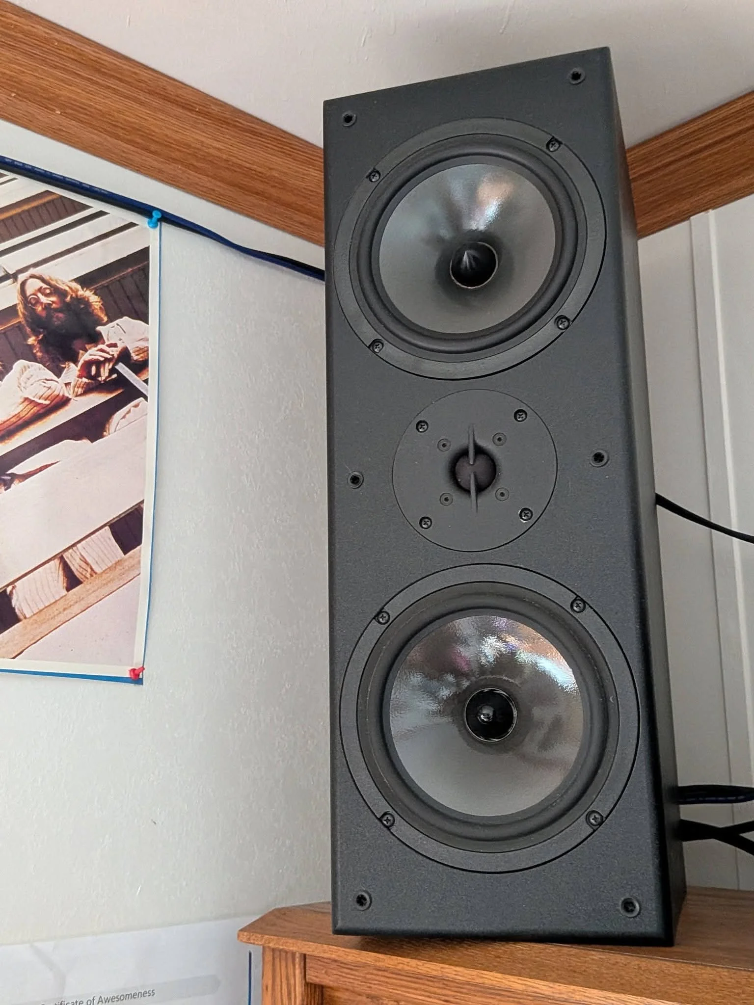

Thx for that info. I might be squared away here. The Ascends are very, very good. The room they were in rarely gets flipped to stereo. So I can find something to fill that hole. For now, some completly stock Minimus 7's. I should still hear your speakers again now that I know a little more about them.
Glad the Ascends are providing a notable improvement. And you should go listen to Doc's speakers again, as his approach treats the room and the speakers as an integrated system, which is the best approach. This is reflected in his posts, particularly response in post #22 (and my comment in post #9 as well). Having the good Doc share his knowledge is akin to having Toole as your personal consultant. He's quite generous and you, Squish, are very fortunate. Bring a bottle of his favorite single malt when you visit.
