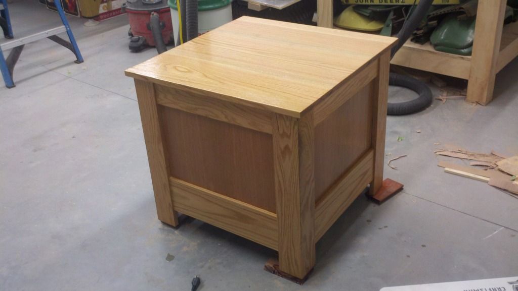

I don't agree. Very talented DIY and cabinet makers out there that can build cabinets that rival the best of the commercial offerings out there for far, far, less money. Check this one out:
DIY...
