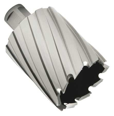

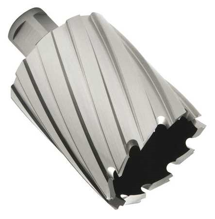

Reading into that thread, I came across where he used a wood boring bit for his larger holes.
I have a full set of these annular cutters from 3/16" - 2". They cut machine perfect holes in steel or aluminum. Can even make O-ring grooves or cut spot welds with them. Very little cleanup after. If my shop owner needs to use them, I make him put up a deposit note with an exact replacement cost.
