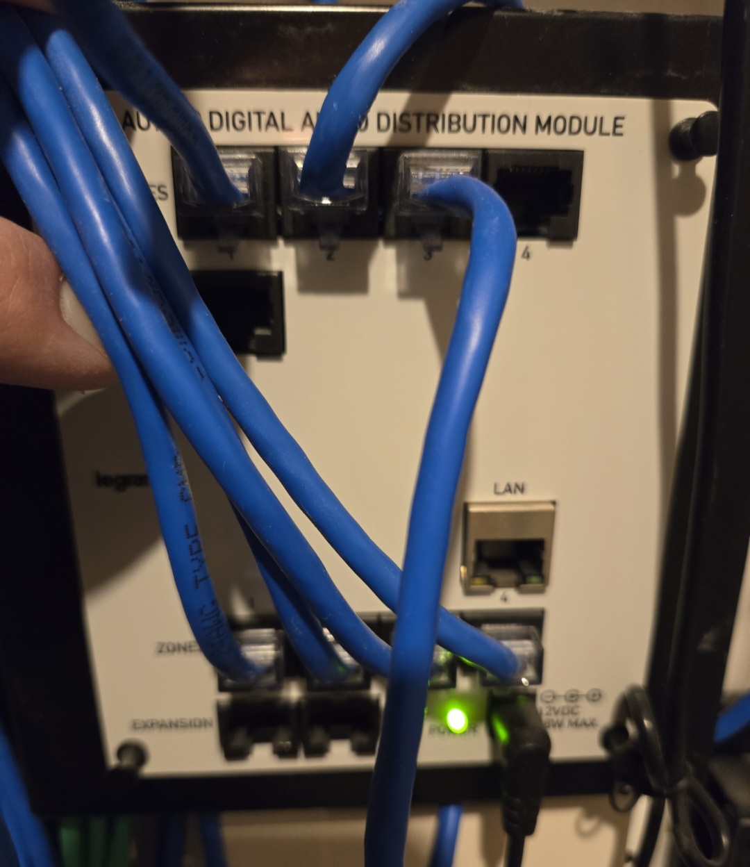

Hi! We have a house that came with a whole house sound system. Everything is wired and works well when I plug in a device to any of the 3 AUX jacks. After doing some research, I found out that this system used to be controlled by an app, but the whole thing is discontinued. It's there anything I can do to get it to work with a different app or reciever or something?
It is Legrand that was controlled with the on-Q app. Thank you so much!

From what little information I can gather it was Chinese junk when new, and now definitely a pile of Chinese junk. I doubt they sold many, and what I could find was all complaints due to non responses. So the App was buggy in the extreme.
Worse there are no manuals available, so I have no idea how it is configured and what is where and how it is all wired up.
I would bet that the installers never put in conduit for the wiring, so you likely can not put in something else without tearing the house apart.
My advice is to leave it and forget it.

This app?
Two of the photos show that the LAN port isn't being used- did you connect that to your router? If not, don't expect this to work.

His system is not and on-Q so I don't think that will work.
I have manage to figure out how the system works and is configured. A unit connects to your router by Ethernet cable, The output of that goes to the controller. Then there are cat5 cables going to each room with a speaker. That carries digital audio and a 24 volt DC supply for each room controller. That powers the control and also a 20 watt amp for each speaker.
So there are no speaker wires going from that central locations. So it is mono only, and I suspect really nasty out of the starting gate. So my advice is to not worry with this system.

He posted "It is Legrand that was controlled with the on-Q app".
I was referring to the LAN port, not an OnQ com port.
ABUS was stereo, but it used speaker wires and Cat5(e). Why would it have to be mono- the cable has eight pairs and with a ClassD amp, two pairs could be used for power, three can be used for separate audio and com can be multiplexed on whatever is available. The speaker wires would

According to the specs of the wall controls that control and power the speakers, there is only one 20 watt amp in each control. Therefore I concluded it was mono. Since the power is provided by the cat 5 cable I don't think any wire in a cat5 cable would carry enough current to power two 20 watt amps at 24 volts.

There is only one Cat5 to each wall controller and only one wire carries power. I think this was a poorly thought out system. No wonder they abandoned it.
How do you mean 'one wire'? One pair?
